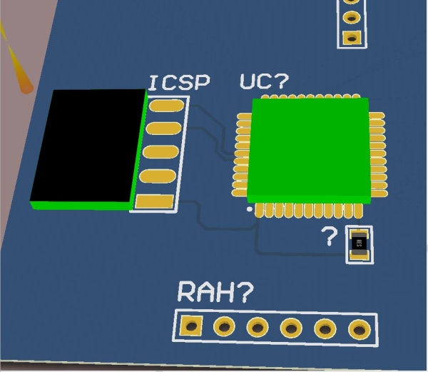

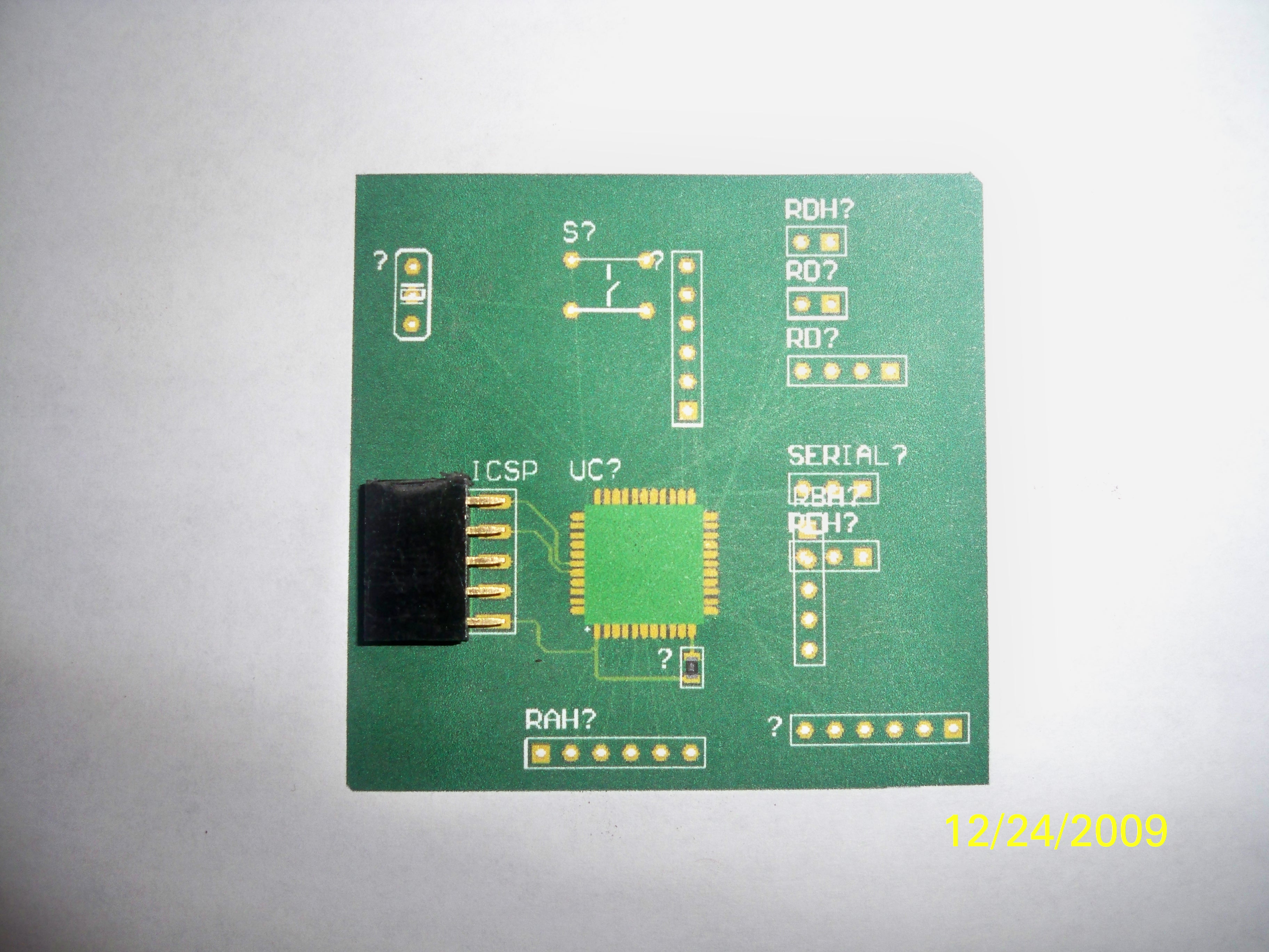

You need to move some signals from top to bottom anyway. I would rather put in a through hole header and let it serve the purpose then add vias.
I second what Mark (you will always be Matt to me :) ) said about not using SMD headers. Same for switches. I have no problem mixing through hole and SMD parts. I use what works best, and sometimes just what I happen to have on hand.
i remade the footprint because Altium has so many its hard to find. But the thing i like is custom footprint with custom 3d i made. Take a look:

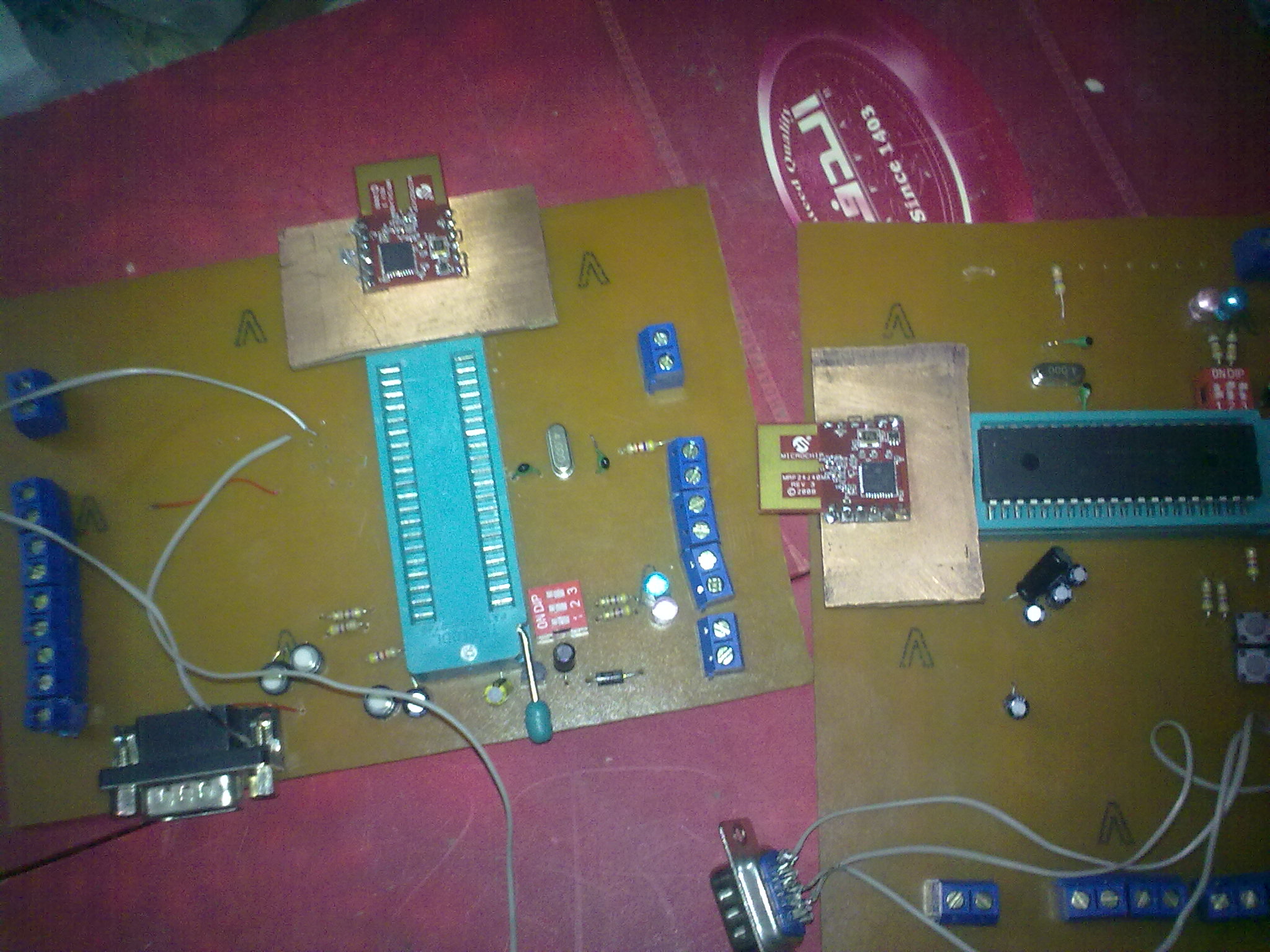

Hi I made 2 clones of the PICDEMZ board and they both work!.Here is a picture of them.Its a single sided design with every thing on the PICDEMZ except the 18LF2620.On one of them i messed up the soldering of MAX3232 and had to make the serial part external but the other one is perfect.I have used screw connectors to provide expandability.Every unused pin has one(the second board has some missing since i ran out of them).

I have a MRF24J40 board; I just need to create motherboard for those antennas (PICDEM Z clone).
Microchip is providing schematics but I have issues with PCB (I don't have footprints for elements that I want to use).
I thought that 3v0 has some schematics and layout for PICDEM Z board.
Anyway thanks for help.
