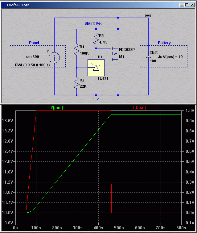

You missed the point. I do not suggest that a Zener be the shunt regulator of choice for the final circuit. I used the Zener in the simulation only to make the point that all of the panel current initially goes directly into the battery with no losses whatsoever. There are losses only after the battery is very nearly fully charged, when it doesn't matter.
For a practical circuit I would use an active regulator consisting of a precision voltage reference like a TL431 with a PMOS current booster.
For example, look at this one:
If anything, its knee is too sharp. It might be nicer if the fall-off of the current into the battery wasn't quite so steep. It is easy to modify this circuit to prevent that: just put a 0.1Ω resistor in its positive lead. Note that this circuit is adjustable by just changing the voltage divider ratio of R1 to R2.

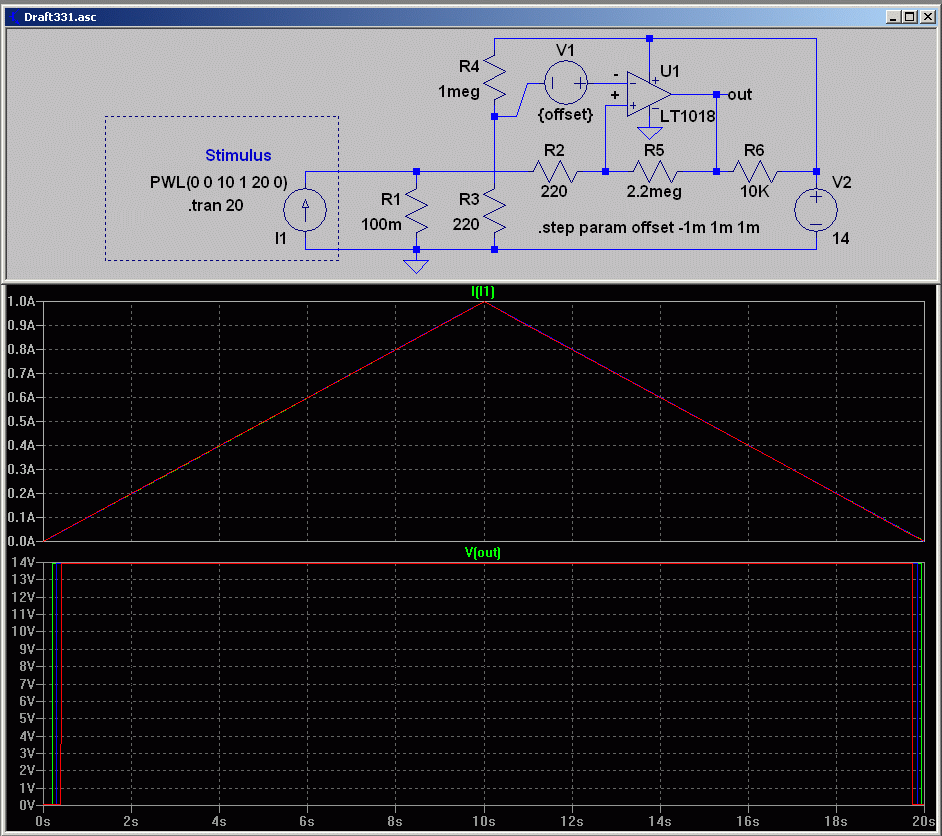

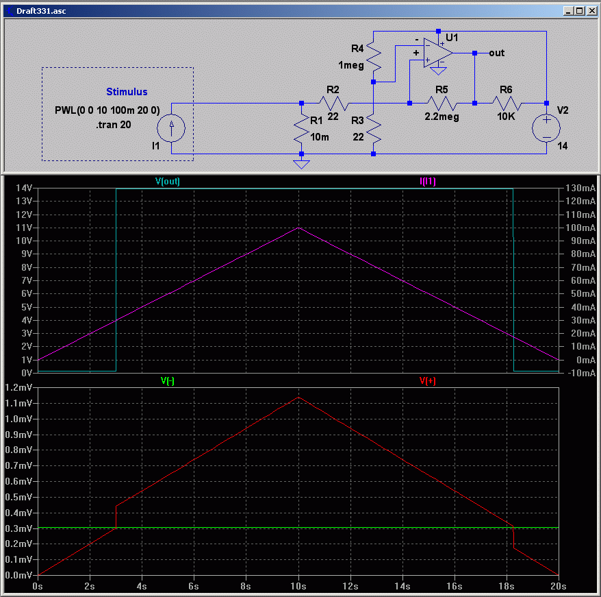

I dont know much about the specifics of charging LiFePo batteries, but I do know how to make a current sensor.
R1 is the shunt. It will go in the minus lead of the battery.
Circuit is powered from the 14V shunt regulator I showed earlier.
Circuit has a moderate amount of hysteresis.
Output is high while battery current >30mA
Output is low as current drops below 15mA
Circuit will work with the LM33x comparators, or a LM358 opamp...

Thanks for drawing up a circuit, just a little point here.
You dont really expect to sense sub millivolt signals with an LM358 or LM339 do you?
I could be wrong here, but i see a 10mOhm resistor for the sense resistor and that only develops 10mv at 1 amp, and the cutout point needs to be much lower than that, perhaps 50ma.
10mOhm and 1 amp develops 10mv, and at 0.1 amp we get 1mv, and at 0.05 amp we get 0.5mv which is only 500ua.
I would think it would be better to use a precision op amp here that has very very very low input offset voltage.
The input offset for the LM358 is already around 2mv, which could be 4 times the signal to be measured.
I am assuming the normal charge current is 1 amp, but if it is higher than that's different.

You can increase the shunt from 10mΩ to 100mΩ and make it work. The Linear LT1018 has a lower input offset (1mV instead of 2mV). I would just trim it for a one-of application.

Hi Mike,
Yes 100mOhm would help some, but it may still be a little close. Some testing maybe.
