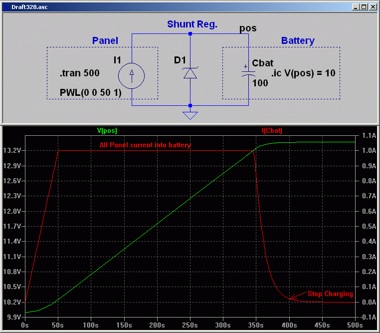

Hi Everybody,
I am dealing with a project to build a mppt charge controller using ne555 or pic based mcu depends on efficiency/complexity…
Charging details are lifepo4 4s 4A (cut of charging voltage @ 14.4v), SP 18v, 1A imp. main issue here is to protect from over voltage (no more than exactly 14.4v) and ofcourse to start chrg at 10v exactly.
I need your assistance to find a relevant schematic that works / tested as an efficient one.
Thank you!

Here is the way I think of this problem:
The panel can be modeled as simple current source. It puts out a nominal 1A at any output voltage between 10V and 14V. You can quibble about the details, but this is a pretty good first-order model.
The battery can be modeled as a simple capacitor that integrates the current into it, and its voltage increases as it does. You can quibble about the details, but this is a pretty good first-order model.
The goal is to stop the battery voltage increasing when the battery voltage reaches a pre-determined limit. A simple shunt-regulator will do than, in the this case a Zener.
The time-domain simulation shows what happens when the "battery" is pre-charged to 10V, and the sun begins to shine. Initially, the full 1A flows into the battery, and none flows in the shunt regulator. When the battery reaches the Zener clamp voltage, the current into the battery decreases as the panel current is diverted away from the battery by the shunt regulator.
Your concern about the battery current going to zero asymptotically can be addressed by monitoring the current into the battery, and isolating it from the panel when the battery current drops below a threshold...

No power is lost with the scheme I showed in post #17. Only after the battery reaches its maximum-allowed-during-charge-Voltage is any available current diverted away from charging the battery. Prior to the battery reaching that voltage, 100% of the available solar current goes into the battery.
