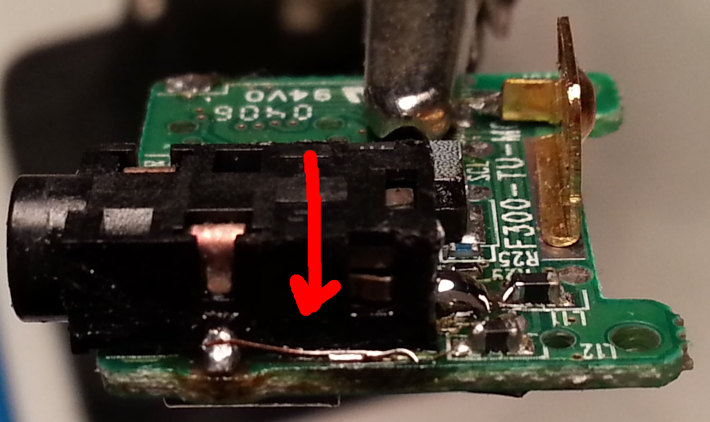

Over the past years it has started to get a poor connection with the 3.5 mm TRS audio jack. I would twist it a few times, add moisture, and it would be good enough to use it for a while. Finally I had enough and thought I'd try fix this myself. The device has two such 3.5 mm audio jacks (one for audio in, one for audio out), I never use the audio in, so I would swap the two, and use the "good one" for audio out.

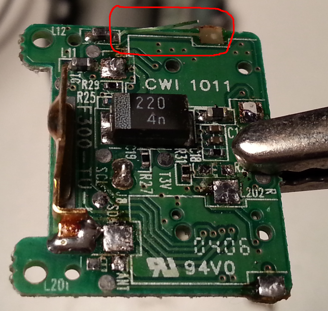

My solution to problem 1 resulted in a torn trace leading up to one of the TRS components, of course this happened on the side that I need to use for audio out, so this must be fixed.

I use a scalpel to grind down to the copper under the solder mask. I use a very fine wire I harvested from some unrelated component to solder onto the now shorter and exposed copper on the torn trace. The other end is soldered directly to the TRS component. I check for continuity and it checks out OK.

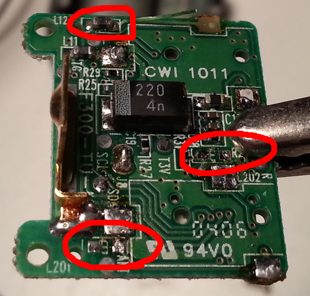

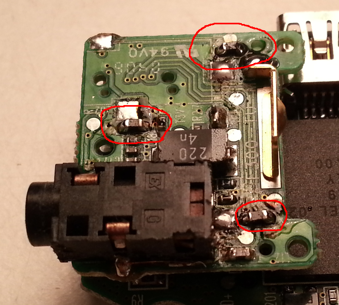

The picture above was taken before the final adjustment to this, and doing this final adjustment I managed to remove the adjacent small resistor. Then I discovered that during my procedure to remove the TRS components in the first place I had managed to knock off two other resistors!
The following three resistors outlined in red needed to be replaced (notice that one of them is in place in this picture, but it also needed to be put back in place).

I have no idea how to do this, nor do I probably have the equipment for it. I imagine I destroyed the resistors using this "procedure" that I thought of myself.
These resistors are so tiny they are hard to even pick up. I prepare the solder spots on the PCB (excuse my terminology) with small globs of solder. I "attach" one end of the resistor to the soldering iron, push the other end gently into one of the solder spots on the PCB. At this point it is so hot that it melts that little glob of solder and "sticks" to that spot. The other end is then gently brought down into the other "solder spot". Since it melts both ends I found that it thankfully sticks more readily to these spots than to the soldering tip, hence it "lets go" of the soldering iron by itself using this procedure.

I measured the resistance in the resistors while still attached, they are all the same, 0,7 ohms I believe. But note that this is measured while they are still attached to the PCB, which I believe gives inaccurate results? It was hard getting them in place so I would like to avoid taking them off again just to measure.
How should I proceed from here? Have I destroyed these resistors? I have an inexpensive digital oscilloscope and some other basic tools.

You won't get a reliable reading of a resistor in-circuit, but it's often good enough to let you know the component is what you expect. 0.7 ohms is incredibly low though (as in you'd never measure it accurately with a normal meter) - do you think you could have a solder bridge shorting the resistors you replaced? Maybe they're not even resistors - you do get little surface-mount chokes in tiny packages.
I'd check what's going on there, and probe about with your 'scope to see if you can find anything that looks like audio.
