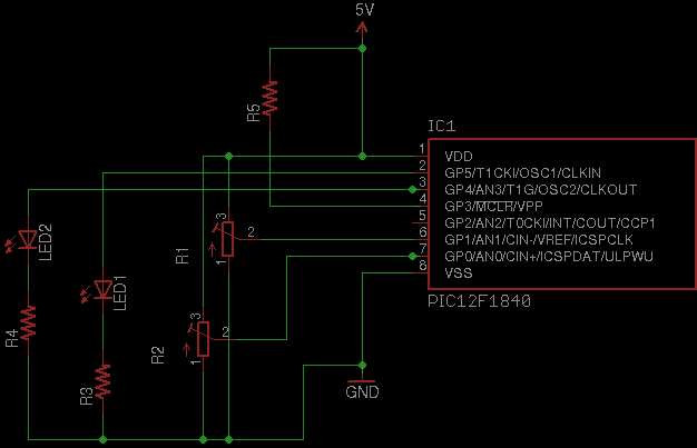

This works but Im still stumped. If it helps Im just using a 2.5k Pot on both AN0 and AN1 to vary the voltage, so impedance shouldnt be a issue. What happens if this: The PIC only sees one voltage, it will turn on one LED and then shortly after, the other one if I keep increasing the voltage. Its strange. Its like the Registers arent being cleared. Ive increased the delays (unless, ofc the delays arent actually working..)
Also changing the channel seems to make no difference.

Your symptoms could be caused by excessive loading on the pins, do you have current limiting resistors on the LEDs?
I just tried that. 1k resistors for the LEDs. Im using Red and Green LEDs. Still does the same thing. There has to be something Im overlooking.

It would be cool if you posted a schematic of your completed circuit. Of course only if you don't mind other people seeing it.

I would be cool if you posted a schematic of your completed circuit. Of course only if you don't mind other people seeing it.

I came up with one very quickly using a preexisting PIC in eagle. The pin numbers are correct but I havent edited the names. GP5/4 correspond to Port4/5. I actually didnt use a schematic, as its very simple.
My supplies for this project came in. I bought myself a pretty sweet Microstick II! It came with 4 PIC's (16 and 32 bit) in 28 Pin packages, which is pretty exciting!
Here.... Try this...
My fault entirely... The ADC routine I gave you was for the older chips... CHS0~CHS4 are shifted 2 not 3....
Also the ADCON tad was a little too fast... I've changed it ...

This works ! Im so happy! Thanks a lot for the help. I should have seen the Shifting issue myself, and I didnt even think of increasing TAD.
The rest of my code should work as well, since it requires just 2 analog inputs. The rest is just math. I feel proud now for being able to program in C. Its not that difficult of a language. I resisted "cheating" by not going to mikroC (because of the libraries and predefined functions)
