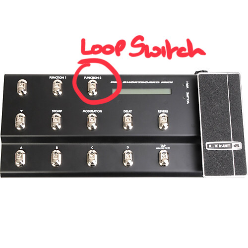

1 - Pedalboard is the outside of the pedalboard with the Loop switch highlighted.

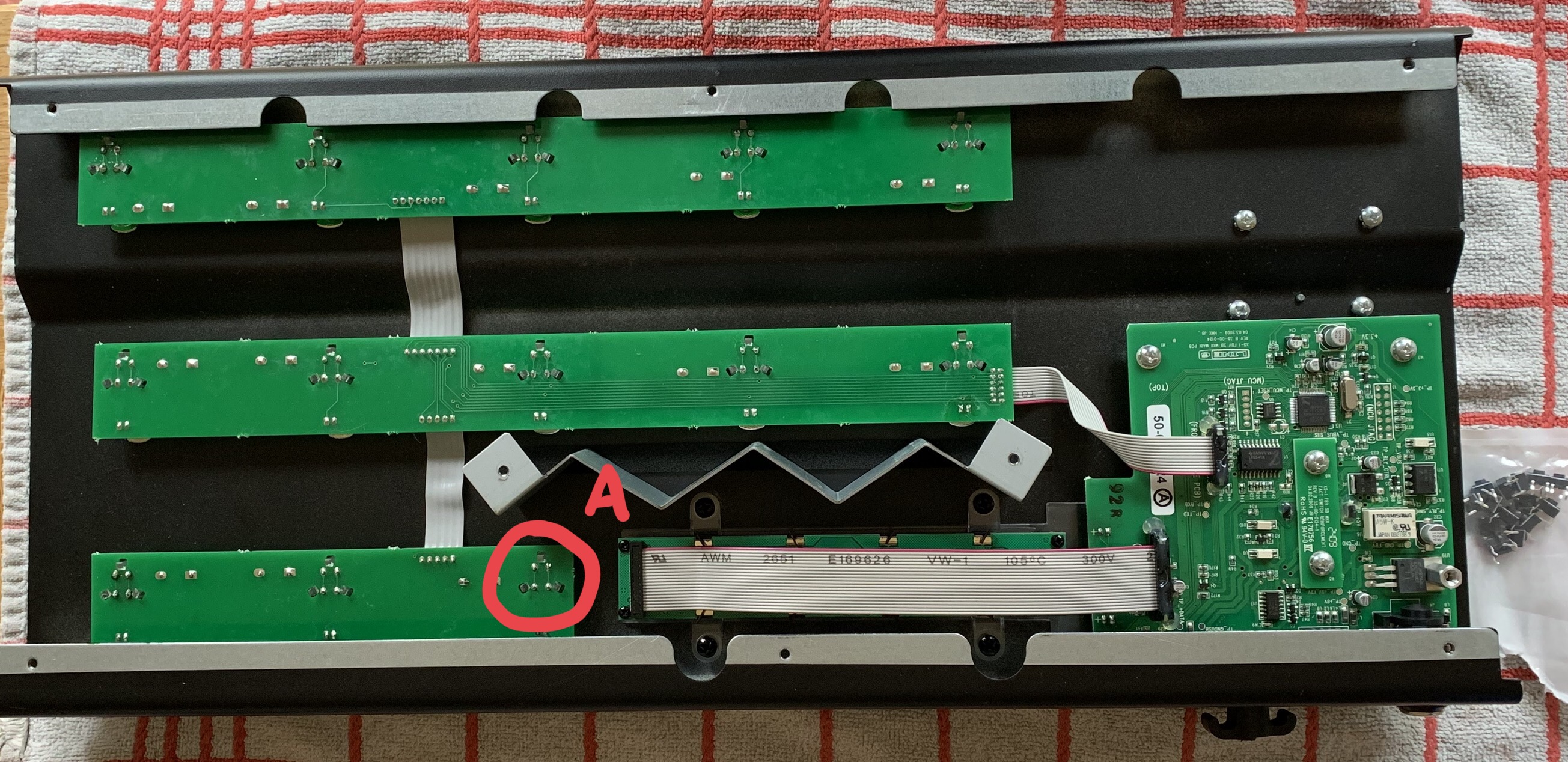

2- The inside of the board with the reverse of the tactile switch highlighted

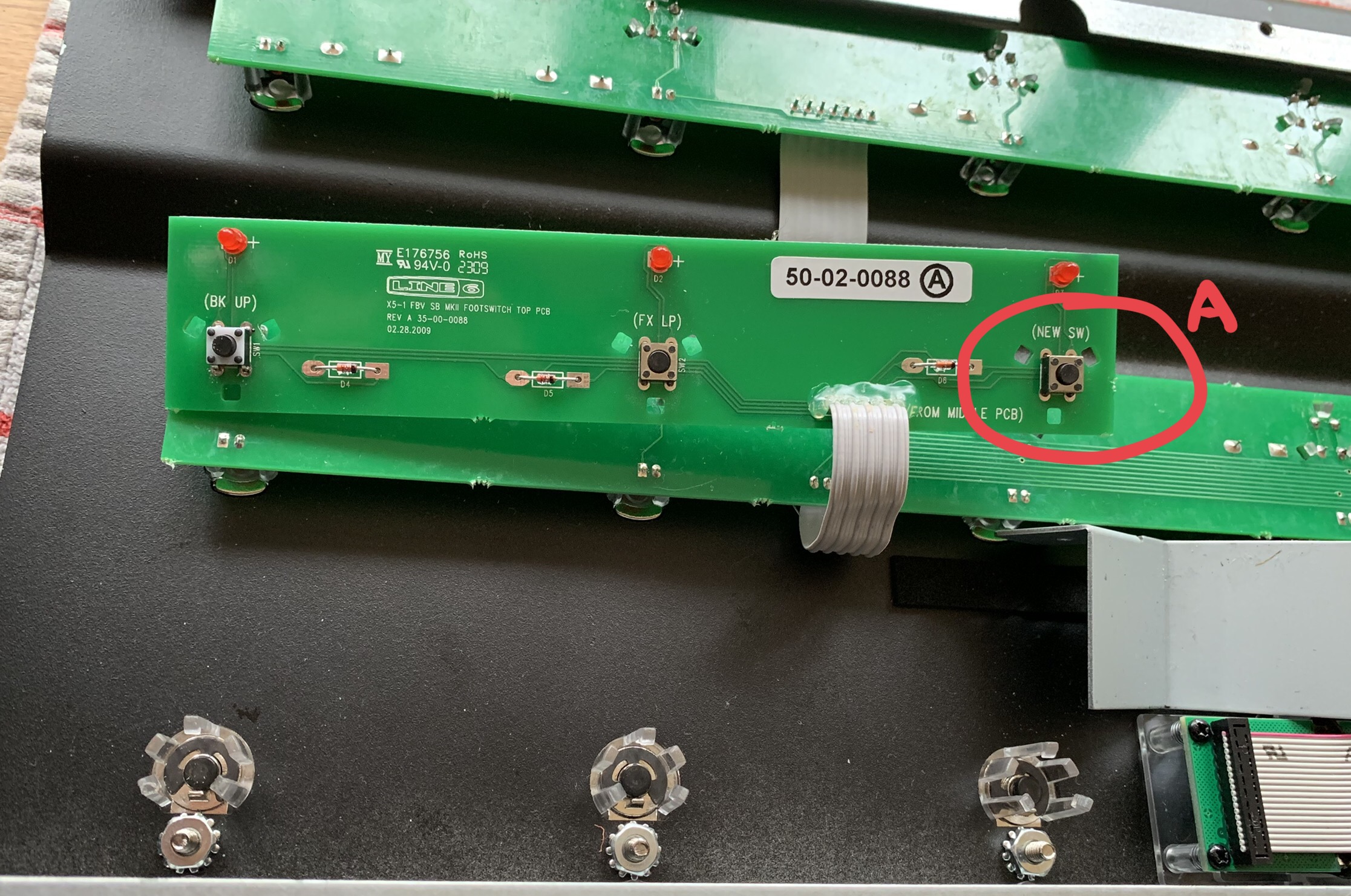

3 - The tactile switch turned over. You can also see the reverse of the individual switch that activates it

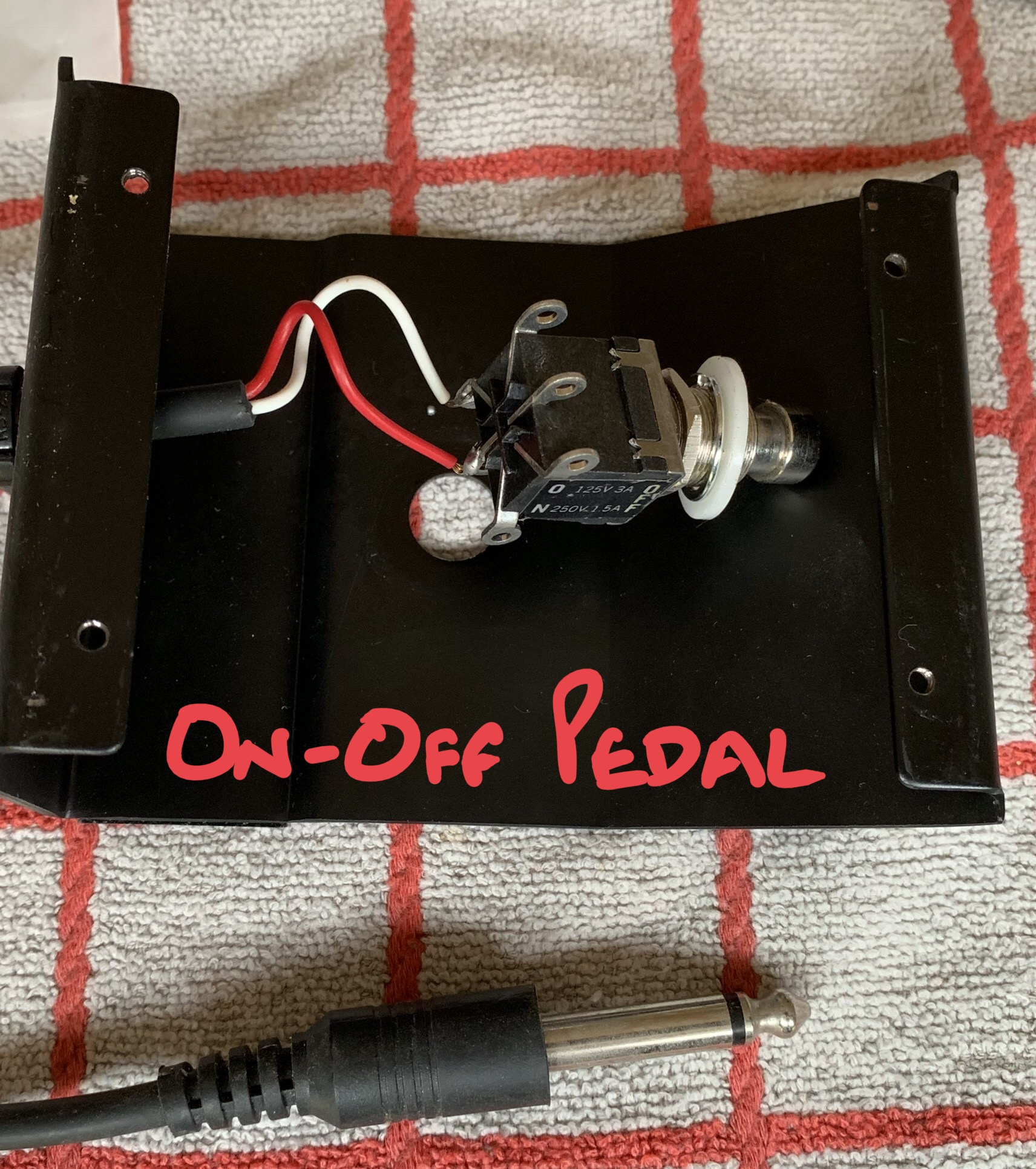

4 - The simple on off switch

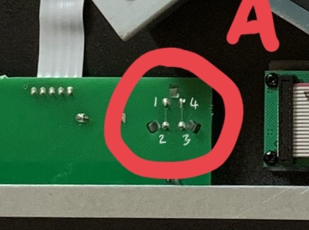

5 - Enlarged image of the reverse of the tactile switch.
So my theory was that I could somehow solder wires to the reverse of the switch then to a jack socket that I could plug the on off switch into. Failing that, hard wire the new wires from the switch directly to the on-off switch.
If this is possible, i will need to understand which pints on the switch go to the 2 parts of a jack socket.

Not all tact switches have the same pinout, so you would need to identify (with no power on the pedal board), using a multimeter set to a low Ohms range or set for a continuity test, which two pins get bridged when the switch is pressed.
It would probably be two diagonally opposite pins.
Thanks for the reply. If I work out which pins are which, how do i understand how they map to a jack plug? I'd definitely rather not hardwire it.
Unless the jack plug has an external voltage source connected (which it shouldn't, because there should only be a foot-switch connected) you can treat the two pins as non-polarised.
Thanks. Does that mean that as long as I identify the 2 pairs of bridged pins I can join them and solder them to either point of the jack socket?
Yes, although there may be only one pair. On some tact switches two of the pins are used only to provide mechanical support.
