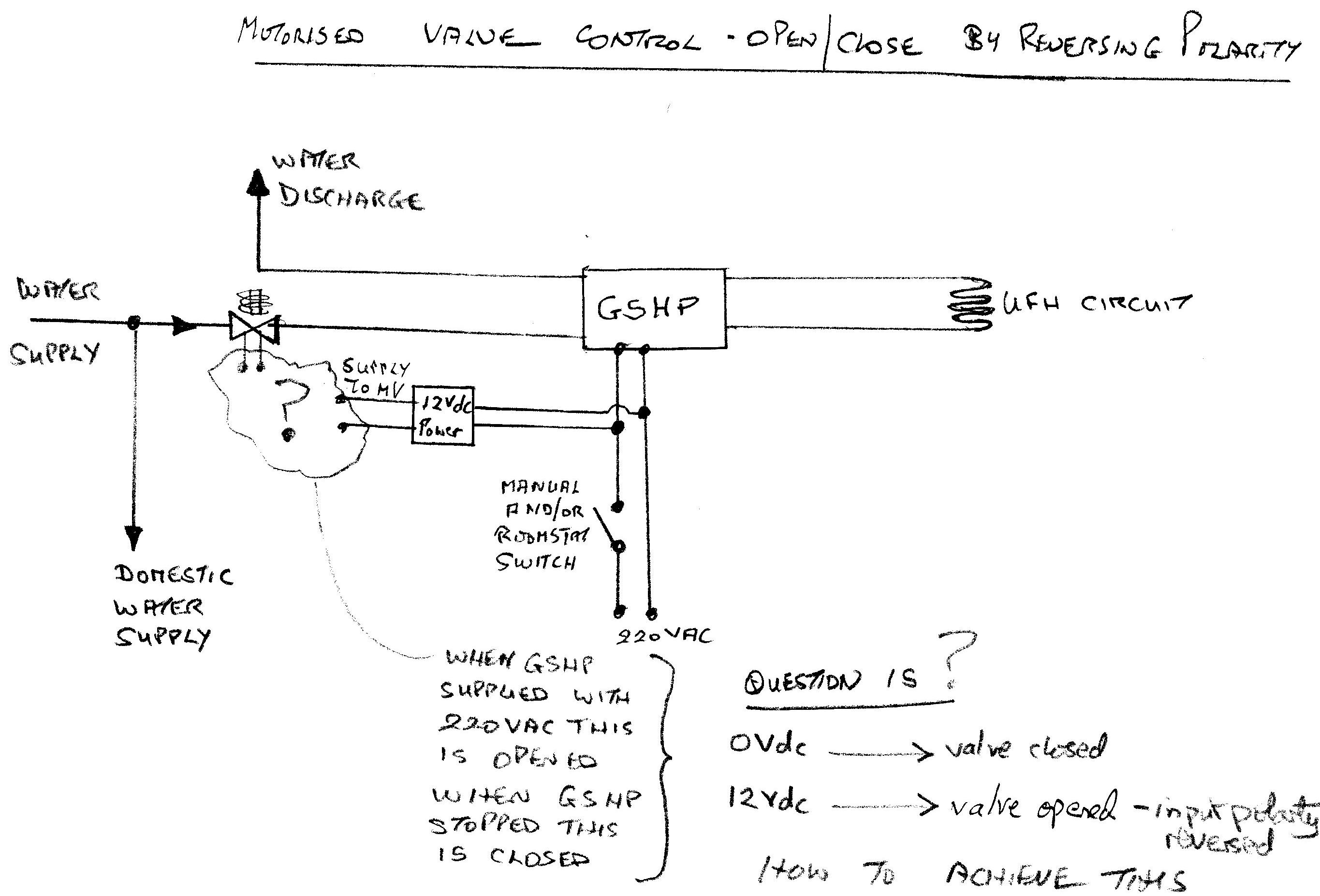

OK guys, this is the full story!
I aim to pump well water through a ground source heat pump (GSHP). When the GSHP is inactive, ie powered down I need to isolate the well water from it, but still keep the well water available for a domestic supply.
So, I intend to use a small motorised valve that is opened and closed by reversing the supply polarity. This can be done easily with a DPDT mechanical switch but I need it to be automatic . The valve needs to be open when the GSHP is operating and closed when GSHP is inactive. Using the 220vac on/off status to the GSHP to feed a 12vdc supply to the valve seems like a good option. The tricky bit that I cannot get my head round is configuring a logic gate to operate similar to a DPDT mechanical switch. I think a transistor/s can be configured to deliver a solution, but my electronics knowledge is very basic-hence the cry for HELP!

I like simple - but I cannot see how your suggestion will work. The proposed system is attached. I need to change the polarity when the main power is switched OFF- this is my only problem. Take a look at the attached diagram.

How would you connect your DPDT switch? - bear in mind that the valve requires power to move in either direction, your circuit shows the 12V disappearing when the manual switch/thermostat is opened.
Easiest way would probably be to use the existing 12V power supply to feed just the relay coil (or even better use an AC mains powered relay avoiding the need for the 12V power supply). Then have the 12V power supply (or a second one if using a 12V relay) powered from before the switch (so permanently powered) and feeding the valve via the relay contacts.

Hi guys. I think I have come up with a simple electro-mechanical solution. My perception of the problem was "How to get the valve motor to reverse when the GSHP is powered down?" That is to say, the valve control needs to be entirely automatic in response to GSHP on/off status.
Two x 5 pin non-latching relays are connected to the motor in a "back to back" configuration.
With zero supply to the relay coils, the 12vdc motor rotates in one direction. With 5vdc supplied to the relay coils, the 12vdc motor is reversed. This motor opens and closes the valve supplying the well water to the GSHP. As is usually the case, the motorised valve has internal limit switches that discontinue the supply at the end of the actuation in both directions so it does not draw any current after completing its stroke. So when the GSHP is switched off, the 5vdc supplying the relay coils (400mW each) is also switched off (a redundant phone charger is sufficient). The answer is provided by an Omron G5LE SPDT non-latching relay from RS @< £1.50 each delivered, inc. VAT. The 12vdc supply to the valve motor is from my rummage box, but could even be a small long-life dry battery. Not a transistor in sight-just the way I like it (I'm a Mechanical Engineer)
I have attached the circuit diagram for your amusement, entertainment and comment (good or bad!). Thanks for all the varied contributions.
PS to be clear, the mains voltage motor on the right of the diagram is the GSHP compressor and nothing to do with the water valve motor.

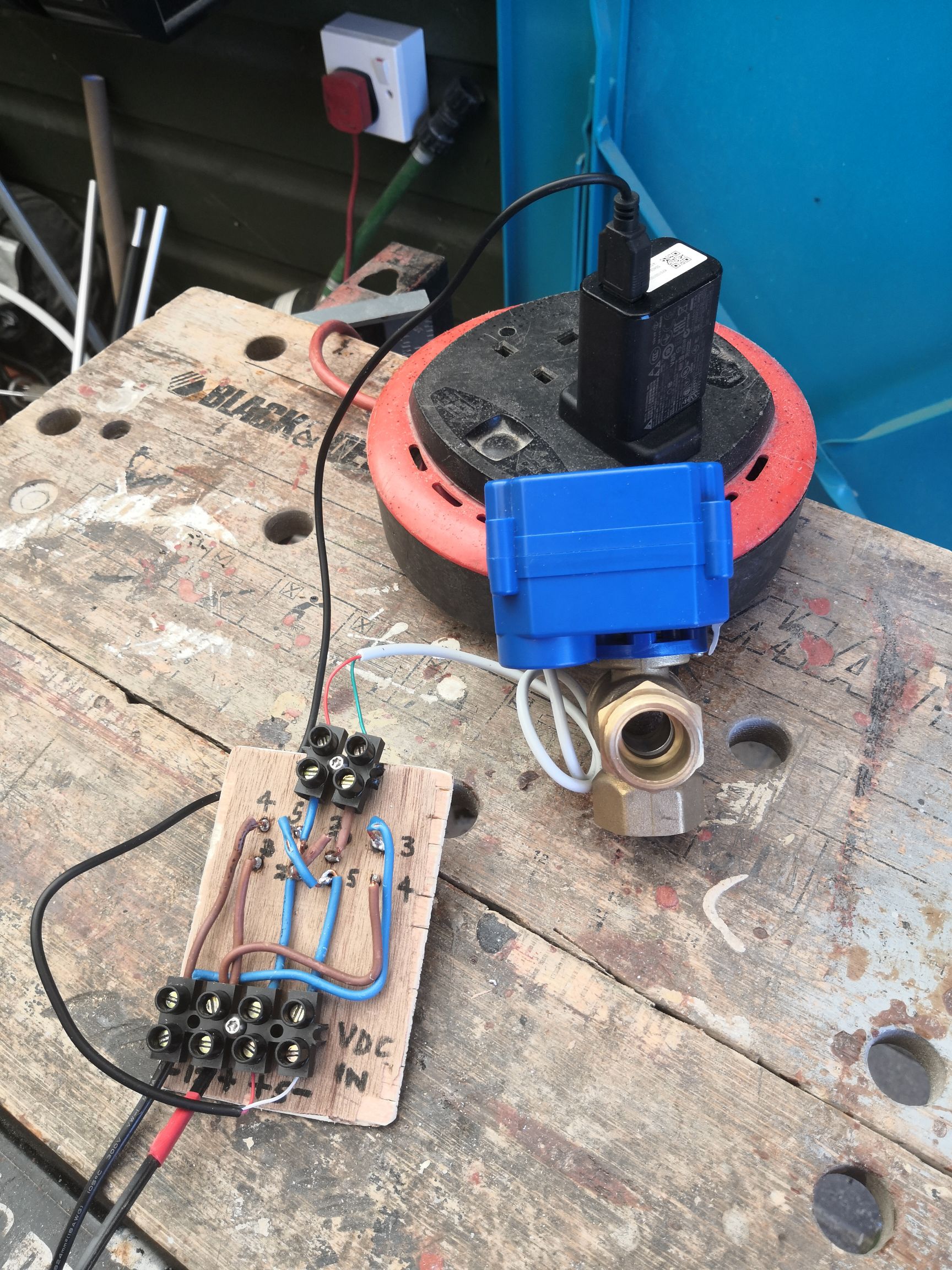

Well folks, I just received the relays from RS and built a Heath Robinson, hard-wired (on a piece of scrap plywood!) lash-up as a prototype and it worked fine. If I hide it in a box will probably use it as the finished product. Pic attached fo your amusement.
