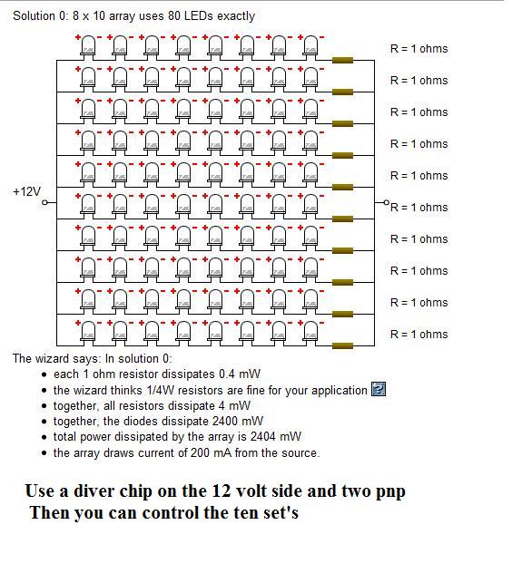

Yes, the way you drew it is what I have in mind. It's just because if I put all 20 in series it would be 70V which the transistors I have can't handle. If I just use the minimum voltage wont the LEDs be really dim?
It is the current that controls led brightness. The voltage is minimum. I can place a LED on a 125v line with a good enough resistor it will be ok
be80be Your solution is totally impractical. You have absolutely no idea how to connect LEDs in series/parallel. Sit back and let others give advice. You have obvioulsy never put LEDs in a circuit like this. I could not think of a worse reply.
Where is master Lol if there was one I have not seen it number one I went with there figures of 1.5 witch is not right I new that it would take a supply at 15 volts to light the leds right
I think some one need to give a Led 101 here if a led forward drop of a red led is about 1.85 volts now if you string them like I showed you will be dropping about 1.85 a led
Let's do the math here 8 leds x 1.85 = 14.85 volts will light all the leds
8 leds 198 Milliwatts x 10 = 80 leds 1980 Milliwatts = 134 Milliamps my way
You are doing 2 things here...
if its 1.85v each red led then there are 10 LEDs in a row. So its 18.5v needed. Since its series the current stays the same as 1 led. So 18.5v @ 20mA will light up 10 Red LEDs with a 1.85v drop.
If its in parallel then its 1.85v needed to power the 10 LEDs but with 10 x 20mA - 200mA
For 10 in Series its : 18.5v @ 20mA
For 10 in Parallel its: 1.85v @ 200mA

Here 8 in Series the big DVM is reading the mA the yellow the volts. There is basically no current limiting resistor "10 ohms "
Have a look I would of done it with 10 but my power supply is only 15.5 volts at 3 amps.
Make you 9 more and that's 80 leds 1980 Milliwatts = 134 Milliamps my way have at it.
Atom led's in series don't work as simple as adding 20x10 = 200 here is why the inner resistance will limits the current.

Ok the way i see it if you supply exact voltage than no resistance is needed...
If you supply 15v for 8 leds which use 1.85v each... (14.8v) thats only 2mV left so to calc that 20mA / 20mV = .02 / .002 = 10
So 10 OHMs in deed
So if your using 10 LEDs you need minimum of 18.5v if you supply 20v then you have 1.5v left and need a 75 Ohm resistor on each strip.
