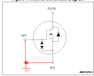

What are you doing with the drain while the gate and source are grounded?
Is the MOSFET an enhancement mode type or a depletion mode type?

Connect Gate and Source to ground:
The MOSFET will act like a diode!
Dose not matter if (P) or (N).

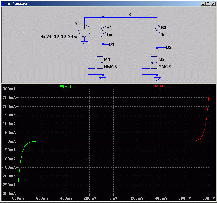

Power MosFets have a body diode: Drain currents [y-axis] vs sweep of V(x) [x-axis].

The question was; what does the D-S look like when G-S is a short. Answer; diode.
Definitely a diode in one direction and theoretically an open circuit in the other direction (like a diode), but dont forget the leakage current which was the point I was making.
