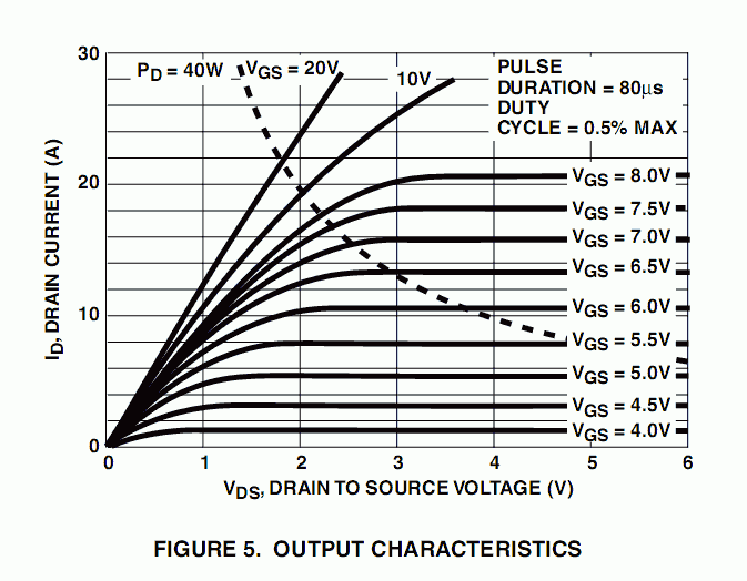

sorry cant find it again, i was thinking maybe a TO-220. i have a jaycar just around the street so supply should be quite easy. Any suggestions would be most appreciated
Just had a quick look at jaycar (australia), not sure of your location - they have a BUZ71 for $4.95 which will work. Seems a little expensive (and it's not a great fet, it does have a large RDSon), if you purchase from Farnell / Element14 you can get suitable FETs for probably 50c (but $10 min order).

You look at the datasheet, in particular the output characteristics graph in handy. Figure for the BUZ71 is attached.
No worries. I hope the graph made sense; if you need any help, just ask.

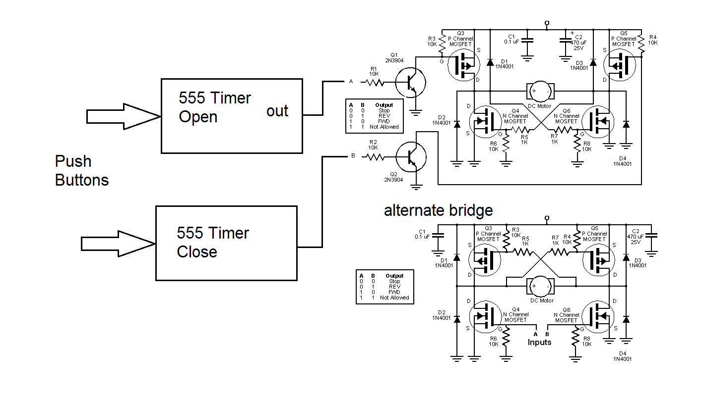

using the 555 as a timer rather than oscillator. Basically using the circuit to control a lead screw extension, e.g. 2sec ---> actuator extends, with an H bridge do the process can be reversed. Just been teaching myself the basics of electronics for projects/ interest so forgive my ignorance
Oh, OK. I just assumed there may be some PWM or something for speed control; there's no problem with switching frequency then... It should all be fine.
You will need both P and N Channel Mos Fets to make an H-bridge or else a driver between the 555 and the FETs.
Here's a couple of bridges you may like or try
