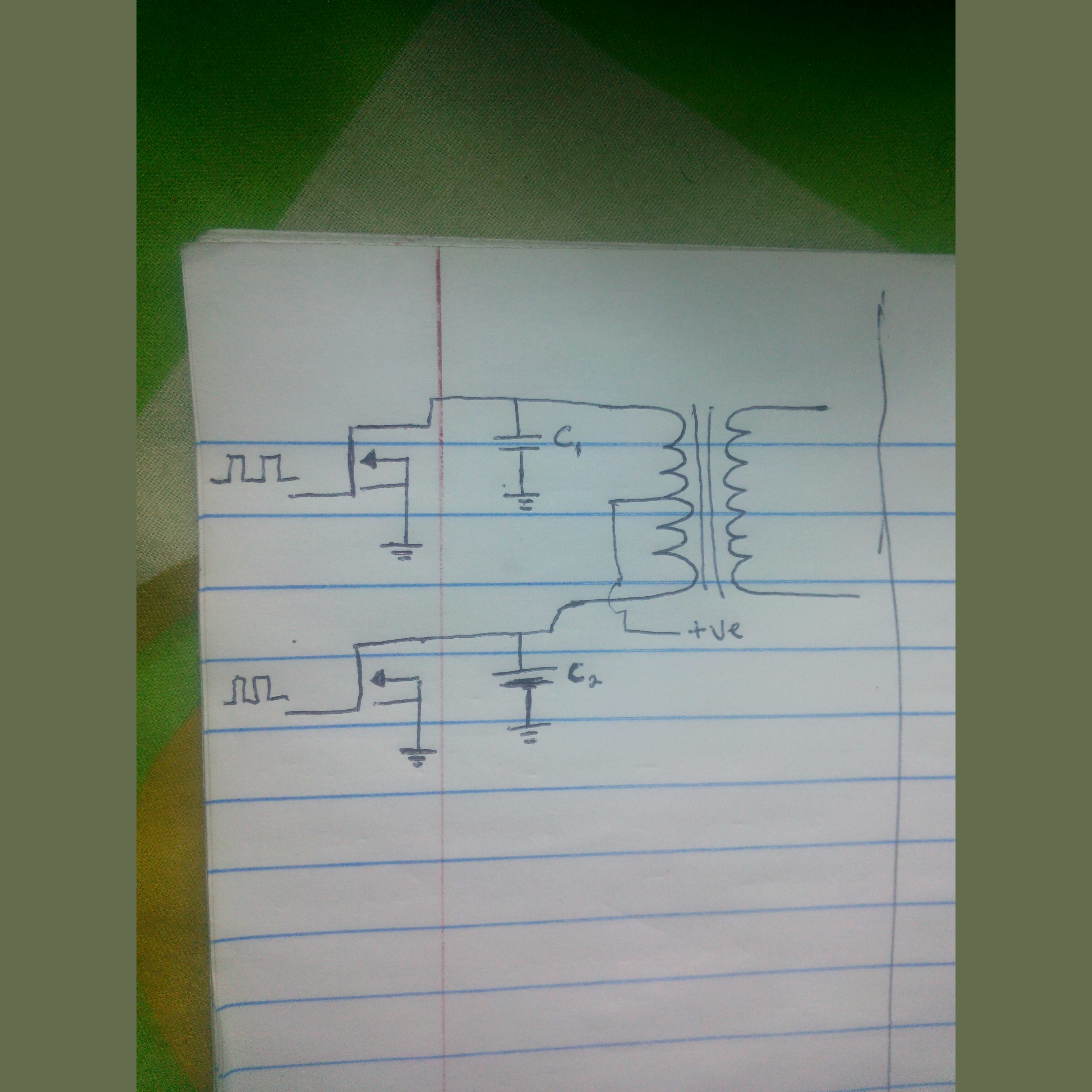

OK I know this may sound Like a silly question but I just need to satisfy curiosity.
The pics below the one with caps C1 and C2, does it make any sense? Assuming the feta are pulsed with either low or high frequency.( curiosity).

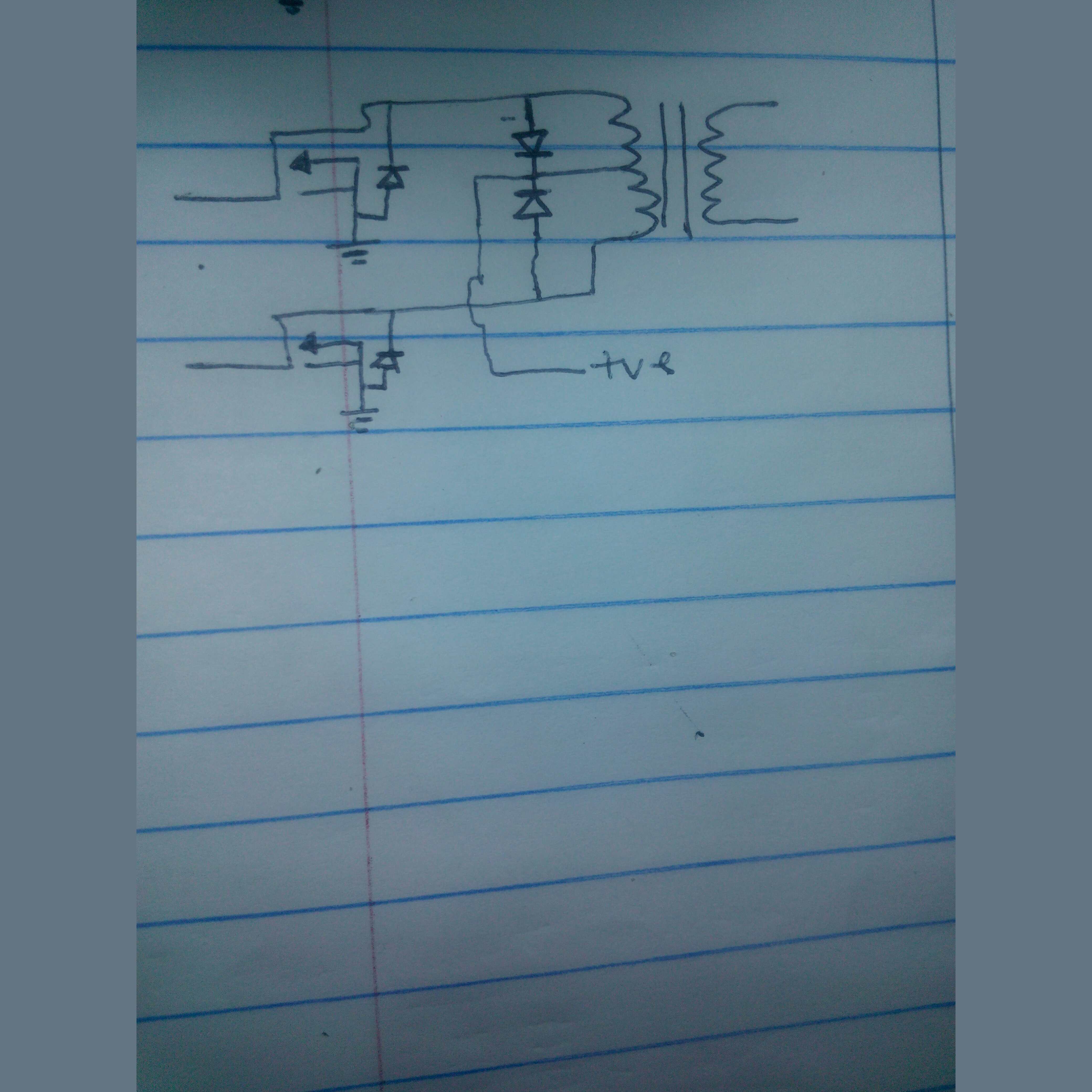

The other pic with diodes,
Now I know the auto transformer action stuff about swinging double the supply voltage but some folks argue that the diodes protect from surges and back emf but I also know they prevent double the supply voltage full swing so what does one do here?
Does the diodes get replaced and with what?
I mean ultimately we want to protect our switching devices and treat them like babies cos they are getting more expensive even if it is by a single digit increase.:)

I think the MOSFET chosen would have a Zener protection > 2x Vout rather than using Diode clamps to both rails.
You better reconsider any devices in parallel at hi amp rating is a really bad idea. Specs are written for typical device there is not golden rule or assurance. It just like putting batteries in parallel if one is weak or stronger they will share the load no way the good battery will try to stabilize the others in other words the good will overwork until it dies. Same idea with tranx, fets, whatever in parallel. There ways to equalize them but at a power loss. Your signal better have space of inactivity or blow up. You need some zener across the gates, When the magnetic collapses there is a lot of un wanted spikes all over.
