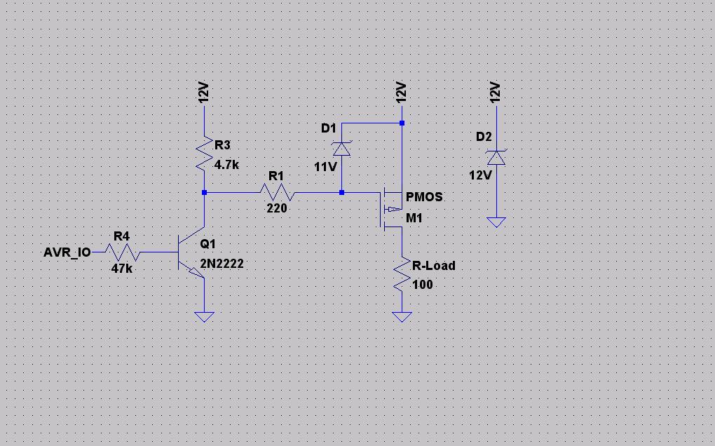

When the mosfet is turned on, I want it to output 12V+ - 13.6V+, not ground. I been told so many things, but I think (if I not mistaken) a P-Channel mosfet is what I need in order to output 12V+.
Well, that's an additional problem.
The P-channel will have source to +12v and drain to load. The MOSFET is off when Vgs=0 (or >Vth), so Vgate needs to be +12v. The MOSFET is full on when Vgs=-8V or so (varies a lot per device and how much current you need, generally between -3V and -12v). MOSFETs can only tolerate a limited Vgs- some only +/-10V, some up to +/-20V but higher is extremely uncommon (and that's an absolute max- including voltage spikes seen in an engine-driven 12v system). So you may just pull the gate to gnd with a whole nother transistor (because a microcontroller can only provide +5v, not +12v, so it can't turn the power transistor off), let a resistor pull it back up to +12v when the transistor's off, but still worry about spikes seen in a 12v system. And you'd want one of those +/- 20V Vgs transistors. Or use a zener to limit the gate voltage.

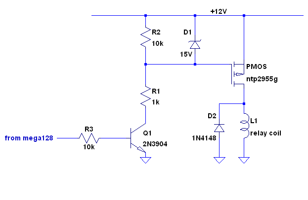

I finally was able to open the files. The maximum coil current on any of the relays was 83mA with 12V applied to them. Why do you think you need one amp?
From your first post,
because I only drawing 1 amp each mosfet and how to hook it up.
The circuit below should work. A high output from your mega128 will turn on the relay.

OK before we all get confuse about something. The relay coils won't be connected to the mosfets. Let me explain a little more about the project.
The purpose of the 5 relays to turn on the loads (Strobe Packs, LED Flashers, Tail Flashers, Etc). The Mosfets are only design to change the patterns to the external devices, this was the reason it needed to be output 12V+, and not the ground. Most of the external devices get the patterns changed when it connected to 12V+. Let me give you the manual to the Whelen Strobe Pack (Strobe Pack). This the Strobe Pack that I would most likely be using. You will see that this strobe pack uses three switches to control the patterns, this was why I need three mosfets for each relay, the relay only controls to turn on the strobe pack (in this case, it the White/Red wire). The patterns are control with Brown, White, Grey wires. Anyway i did pick a more better dual mosfet that is a Low Level P-Channel.
STS4DPF30L
I had talked to someone else on another forums and he helped me out a little about how to connect the mosfets. I will attach the file to show how he had it connected. Oh, I will be driving the relays using a UDN2981 and driving the mofets using ULN2003A.
