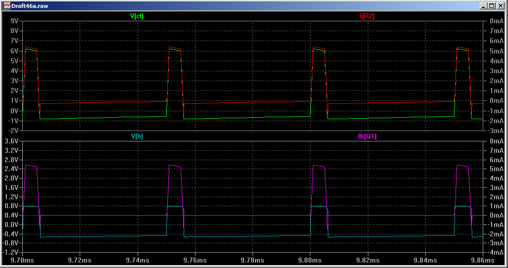

The yellow trace is the relay coil current. The gray trace is the current through the snubber diode. They are equal between 57ms and 90ms. Note that the inductance of the relay coil is what determines the rise and fall time of the coil current. I never met a "power" relay that operates in less than about 25ms. V(out) shows when the relay contacts close/open.
A 2N2222 will tolerate a max base current of up to ~80mA @ a Vbe of ~+1V. The max voltage across the burden resistor to approach 80mA into the base would be 1+1000*0.08 = 81V, so I dispute that you need D2/D3. Note that I moved D1 downstream of the 1K resistor so that -Vbe gets clamped to ~-1V without upsetting the burden resistor voltage..
Here is a detail of the voltages and currents at the input of Q1 based on a reasonable guess of leakage inductance of a 20kHz Current Transformer:

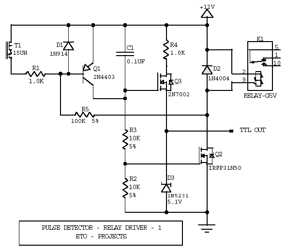

Here is the upside down version, with a TTL output, plus a little hysteresis (R5). to keep the relay from chattering on release.

It occurred to me that the way the transistor is used, it is a "peak" detector. As such, it will respond to even a PWM signal with a very small duty cycle such as 1% or 2%. You might be better served by a detector that responds to the "average" of the PWM signal, such that it is off for less than say 10% duty cycle, and on for more than 10%. To do that, the detector would have to be more of a Low Pass Filter followed by a comparitor.

1. why R3?
2. why not eliminate Q3 and connect zener D3 with load resistor R4 in series to Q1-collector?

To AnalogKid: for the TTL output, why not use a voltage divider resistor set of about 2k instead of D3, Q3 and R4? The input impedance of the load (an MCU) is 10k.
Because Mike added it. I think it can be eliminated.
Because I focused on a semi-isolated TTL output. Your suggestions is better.
The zener gives a constant output voltage over a range of currents from 0 to around 7 mA.

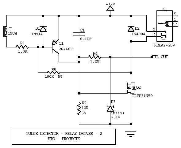

I put the R2/R3 voltage divider there to control the peak gate voltage on the PFET. If running on 12Vdc, without R3, the peak Vgs would approach the supply voltage. That may or may not be ok depending on the PFET.
Here is a reworked version.
ak
ok, thank you! Your suggestions will be applied.
ok, thanks MikeMI; I think of using FQP30N06L because I have it lying around.
