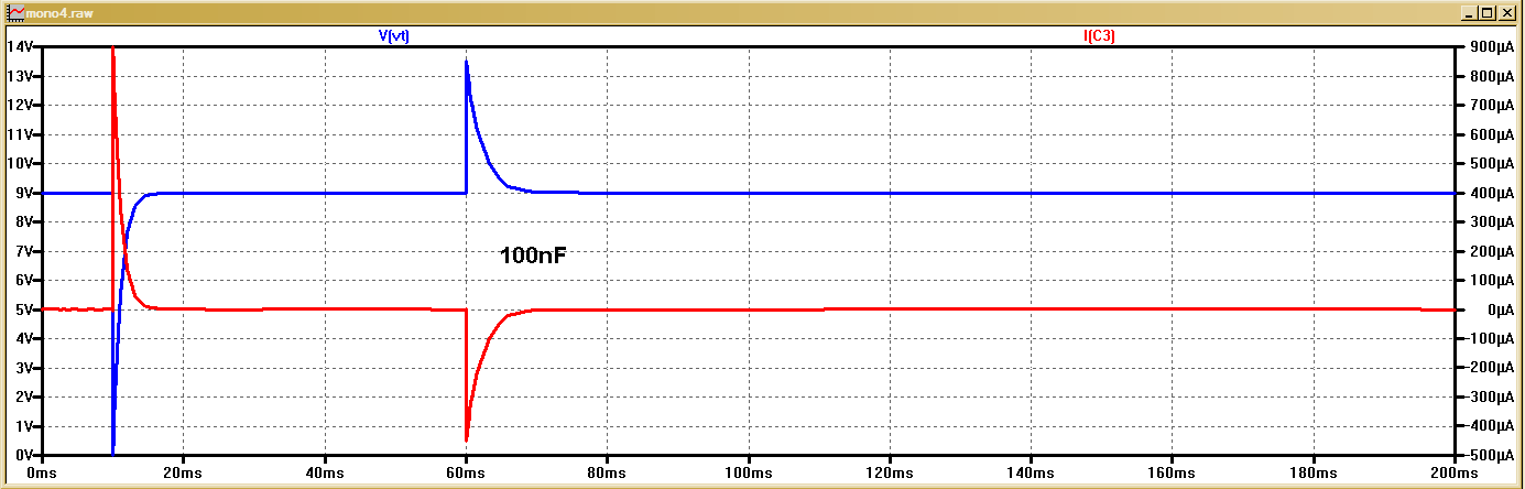

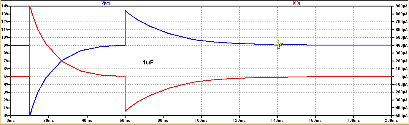

IMO its not only the Vpk at the Trigger due to the coupling cap, one has to consider the 'total energy' of the overshoot, this I believe is responsible for damaging the 555 trig input when high value capacitors are used.
I have run 3 sims with 10n,100n and 1uF caps, ref the images. [ the RED plot is the Cc current versus time]

Hi Eric,
Yes i believe that too, but then again all the spec's i've ever seen dont specify a time or an energy level, just a voltage level such as 5v, 10v, etc. In other words, they will spec an input pin as allowing some maximum voltage level like Vcc+0.5v or something like that...ie they dont say "Vcc+0.5v for 1ms, Vcc+1.0v for 100us, Vcc+5v for 10us", they just say "Vcc+0.5v" and that's it. This is the way it is in the transistor world too, where the breakdown is considered to take no time at all once the threshold has been exceeded. This is probably why they never specify the time period or the energy unless it has some other significance.
Also, it would be hard for us to access the damage with varying voltage overshoots and time periods. For example, we might know 10v for 1000 seconds is damaging, but how do we access 10v for 1us for example...does it do damage or not? The only way i myself can be sure is to never allow the voltage to exceed the spec sheet max spec cause that's all the concrete knowledge i have about that kind of specification.
This is pretty much standard practice though, with inductors too as im sure you know. With capacitors in some pulse circuits there's also the chance of the voltage going too negative, in which case a diode clamp to ground is used. It's more common with inductors, but caps can also be a problem.
Make sense?

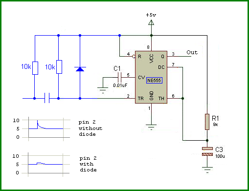

The second 10k cap pulls up the trigger input (pin 2) of the 555, keeping it positive when there is no trigger signal.
The first 10k pulls up the trigger source and may not be needed if the source already has an active high output.
We were talking about overshoot on pin 2 earlier, and this next diagram helps to illustrate this possible problem. As shown in the diagram, a diode (like 1N4148 although a Schottky is better) is used to clamp pin 2 to +5v (this example uses a +5v power supply). When the input trigger goes high the voltage across the cap adds to the input signal for a time equal to about 5 time constants. This means pin 2 might go to twice Vcc for a time (after all the new cap and the second 10k resistor make up a voltage doubler circuit). The diode is there to clamp this to a safer 5.5 volts or so instead of 10 volts. It is possible that the CMOS versions of the 555 already have this diode though, but it is unknown if the regular NE555 type has this diode or not.
The other requirement for this diode or one already in the 555 is that the power supply impedance has to be low enough to be able to sink any current from that diode. This could require an extra resistor across the 555 power supply terminals in some cases. Alternately, a zener could be used to clamp pin 2 to ground instead.

Yes, i replied with those questions in mind, see that post just before yours. I also talked about a possible diode clamp.
