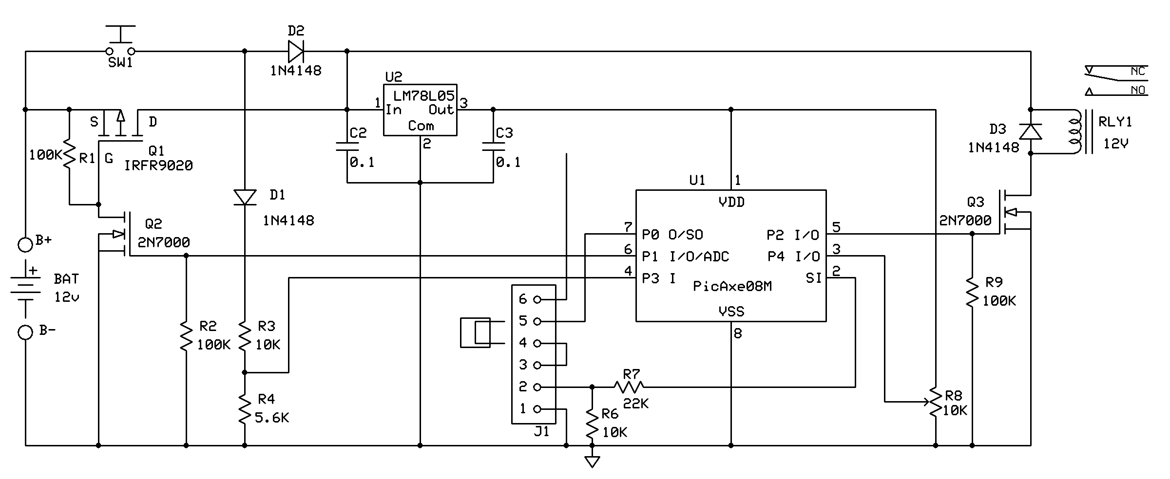

I couldn't help it...I had to try it.
'Picaxe....08M Push-ON/Push-OFF/Program-OFF Power Switch
'Use with 08M Power Switch 05a circuit
'Checking for terminate call with an Interrupt
Start:
	High 1				'Turn on power
	Low 2					'Turn off output
	Pause 100				'Debounce
	If pin3 = 1 then Start		'Check if Push Button is still down
	setint %00001000,%00001000	'Set interrupt for pretime terminate
Time:                                         '0-60sec
	ReadADC 4,b0			'Get timer variable
	High 2				'Turn on output
	for b1 = 1 to b0                   '1 to 256 loops
	pause 241
	next b1
	goto Terminate
Interrupt:
	goto Terminate
Terminate:
	Low 2   				'Pin 2 low to kill output
	Low 1					'Pin 1 low to kill power
	stop
Ken

I've just received the PixAxe kit along with lots of other components to try to achieve the same goal in different ways. I need to solder the starter kit together and work my way through the PicAxe manual and try to get my head around the concepts. I can follow the circuit and code you've given to an extent, but would you be able to write a brief outline of the logic that is going on? I assume that the momentary power switch fires up the MCU, which then runs the timing loop unless there is an interrupt which powers the whole thing down again? I also can't work out what J1 does - especially the bridges between some of the pins that seem to go nowhere - is this a standard connector on the PicAxe board that serves some function?
Thanks for all the help!
First, J1 is "my" connector to a programming cable from the circuit to a PC serial port. On the 08M, P0 is used both for serial out (for programming and other serial communications) and as a general purpose output. So, 4 to 5 would be jumpered for program down-loading. If P0 were used in this circuit, the jumper would then be moved from 5 to 6. Pins 1,2, and 3 are Rx, Tx, and Common to the serial port. I generally use this on boards when I want to reprogram the chip in-place.
The logic....
When you push the button, it supplies power to the 5V regulator and to the PICAXE chip, and to P3 through a 12V-to-5V voltage divider.
The program starts by setting P1 high, turning on Q2, which turns on Q1, which latches on power to the the regulator and chip.
The program next sets P2 Low, assuring that the output to Q3 and the relay is off.
The PAUSE is to account for a small amount of on-off bounce in the switch contacts.
The IF statement looks to see if P3 is low, meaning the pushbutton of open. The timing doesn't start until the finger is off the button, otherwise the program may think it's a shut-off push.
Once P3 goes low, it sets an interrupt mask for the next high on P3.
The time interval is adjustable, set by a 0-4.5V input from R8 to the 8-bit ADC input P4.
The timing portion first reads the 8-bit voltage on P4 into variable b0.
Output P2 is set high to turn on Q3 and the relay.
The for-next loop, repeats the number times set by the variable b0
The pause within the loop sets the delay time within each loop. This constant was fine tuned to 60 seconds max, by trial and error.
At the end of the for-next loop, a jump is made to Terminate to shut off the relay by a low to P2, and the power to the circuit by a low to P1.
If the button is pushed during the timing loop, P3 goes high, the interrupt is called, and the program jumps to Terminate.
D1 and D2 are steering diodes to isolate the P3 divider from the input to the regulator when it's powered by Q1.
Hope this helps.
Ken

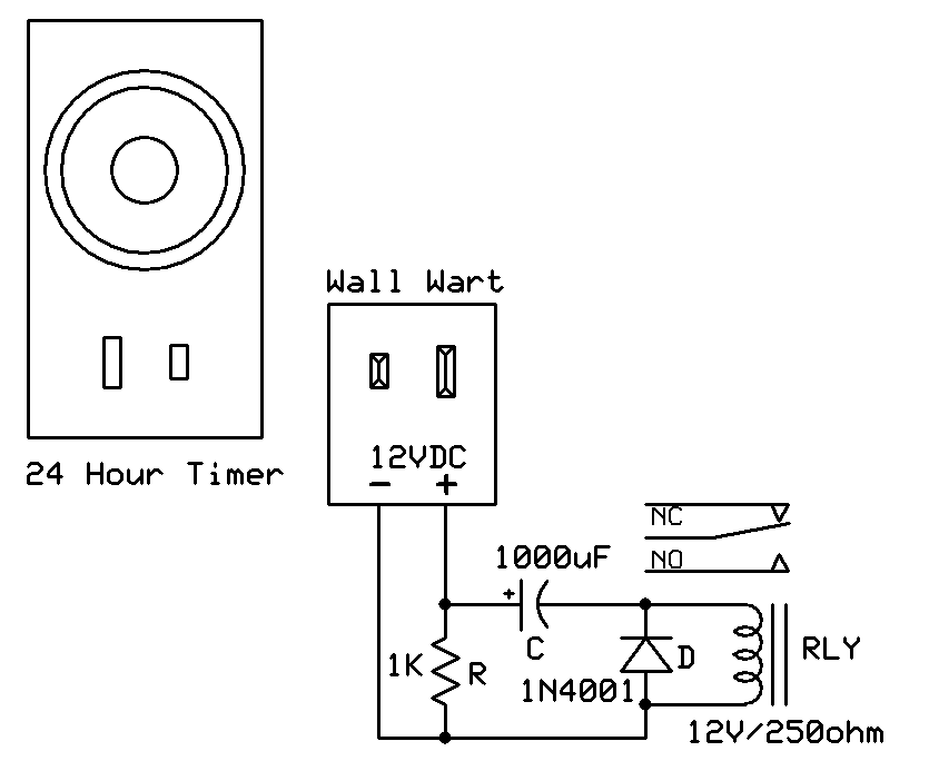

Looking at your circuit in detail, I was wondering how I can interface it with the existing 24h timer - this can either use a logic high from its own internal circuit, or the switched 12v output from the relay connected to it. The problem is that both of these switch on constantly for a minute or more - and I want to use the set timings in your circuit (40 seconds or so), rather than this minute pulse.
What's the best way for me to interface the two circuits so both the momentary button and the minute-long pulse start the timing circuit?
At present if I simply connected the 24h relay in parallel with the momentary switch, the PicAxe code would ignore it as it would be considered to be a held-down button.
This is a circuit that I've used to get a momentary switch closure out of a wall plug timer, rather than it's normal 1-minute (digital type) or 15-minute (motor type) minimum on-time. My on-time depends on the coil resistance of the relay and the size of the capacitor..
Ken
Haven't you sorta lost the bubble viz-a-viz the zero power consumption between pulses????
Thanks for the circuit Ken - this looks good. Will this just briefly pulse the relay then only reset on power loss?
Mike - the 24h timer side of the circuit is solar powered with a small lithium cell to keep it going through the night, it's the logic side and the override momentary switch that I need to stay at zero idle consumption - it will also probably be solar, but the small solar panel won't support the microcontroller and relay constantly drawing current.
