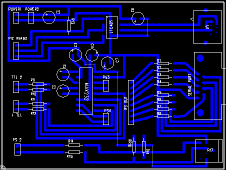

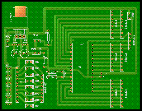

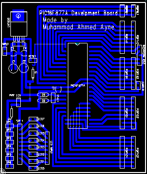

I am making Boards for me & Just want to share them.
Main Board
PIC16F877A
LM 7805 Regulator
Inchworm connector,
Two conector for all the PORTS,
8 LEDs with SIP resistor connected to a header just for Logic Scope
One LED on Supply.
Comunication Board
RS232 TO TTL converter (MAX232)
RS485 connector (LTC485)
PS2 to PIC connector
4x4 Matrix Key Pad
Share ur comments on these boards and what should be the next boards for me (I mean for a learner)
Thanks.

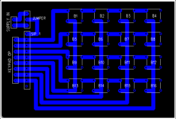

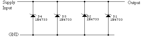

Protection
Now i am including this circuit to my boards cuz all of my boards will take supply from "Main Board",
and there may a little mistake happen, i can connect wire in wrong direction.
All zeners are 5.1 Volts.
What u say it is right way or not?????
And -870mVolt can burn digital IC's???
PIC's are amzingly robust - if you connect the power the wrong way the I/O pin protection diodes are forward biased and short the supply out. The chip will get hot, and presumably eventually kill itself if you don't notice.
I've got a PIC 16F628 I placed in the socket the wrong way round, that still has my fingerprint burnt in the top of it! - and that still works fine (PIC as well as the finger!).
It means n oneed of zeners for protection???
once i connect PIC(16F877) with +15 Volts for 3 or 4 seconds by mistake, it burnt, it not working from that time...
my second question,
15V is a LOT too high, and I would expect it to kill the PIC.
my second question,
My previous reply explained that!.

This is just a suggestion.
If you are building the boards for fun and learning why not post the schematics. Doing so may generate some useful suggestions.
If you think others might be interested in the board post eaglecad files (or similar) so others could use the design.
3v0
Infact i am building boards for learning purpose.
and i am not making the schematics for these boards i am directly making PCBs i just saw some boards for guied line.
It will be available for all but later when i will make web,
my web will be about my all the projects.
Are you using a PCB cad program such as EagleCad ? (I think I see a unrouted wires on the mainboard) If you have a problem with a board it is easier to get help if you can post the schematic. You can make very professional looking schematics and boards with this tool.
An article about making your own boards using EagleCad
. This link did not work just now but it has in the past. I do not think it is permanently broken.

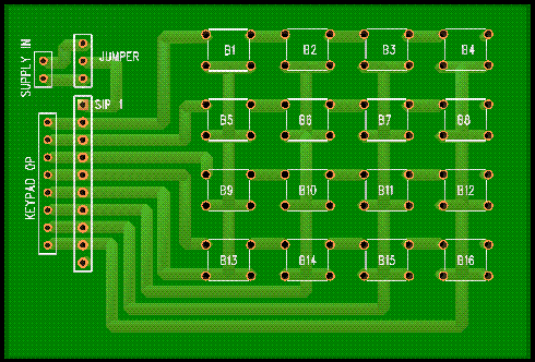

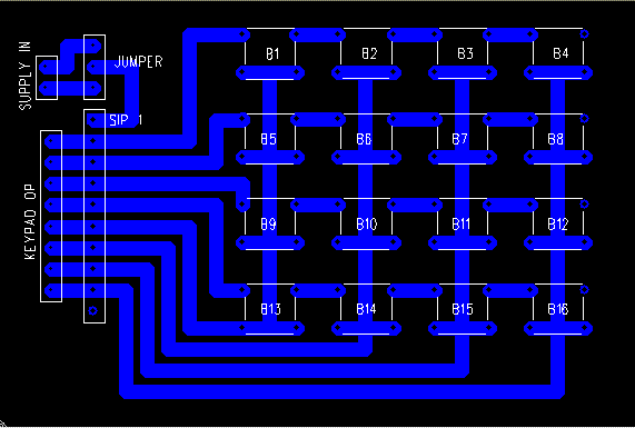

Key PAD
4x4 Matrix Key Pad,
3v0
