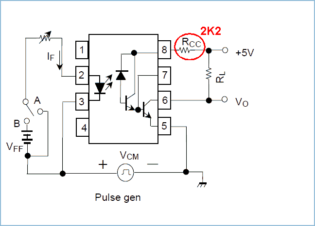

The odd thing is (following the circuit above) the 6n138 gets extremely hot when I connect pin 8 to +5V and pin 5 to GND. I was reading through the datasheet and the 6n138 should be able to handle a Vcc of +7V. I double checked to make sure my power supply was in fact providing +5V which it was. Am I misreading the datasheet?
I originally noticed the problem after I completed the circuit and turned the power on for the first time. I assumed that the 6n138 I was using was bad so I tried another one which had the same problem. Okay back to the drawing board. I then removed everything from my breadboard except the 6n138 and the wires going from pin 8 to +5V and from pin 5 to GND and it STILL overheated (Good thing I purchase a lot of these things).
The next thing I did was introduce a resistor between pin 8 and +5V. According to the datasheet the output current is about 60mA so I decided to use a 100ohm resistor I had lying around which dropped the voltage to about 3.9 and current to around 40mA which should be well within operating values. The 6n138 no longer overheats but it still seems odd to me that I needed to introduce the resistor because the above circuit doesn't use one.
Okay so now that the 6n138 is not overheating I re-connected the circuit but still without any luck. One thing that bothers me is the LED between pins 2 and 3 will be OFF when there is no MIDI data. The 6n138 is inverting (is that the correct term?) the signal meaning that PIN 6 will be HIGH when the LED is OFF. Is there a way to measure this? If I put a voltmeter between PIN 6 and GND I get about +3.9V. Does this make sense??
If it's getting hot then you've done something wrong, connected wrong way round perhaps? - it may be toast now.

Do you have a pullup resistor on pin 6?.
Whoever design the original circuit have just copied the manufacturer test circuit without much thinking.
For the performance of the device to appear better, the manufacturer is testing the device without a load resistor but place restriction on the frequency and duty cycle of the input test signal instead. That's why the manufacturer can use the device without a load resistor. It does not mean one can use them in this manner.
In your case, to prevent overheating, you have to use a resistor instead. See the image from a Toshiba 6N138 datasheet and it indeed has a resistor Rcc. I think 2K2 is suitable in your application.

Thanks for the response. I was able to determine my problem. It was truly a rookie mistake on my part. I had +5V going to GND and GND going to Vcc on the 6n138. Apparently that's not a good thing to do. In any case it's working 100% now. :)

Agilent's datasheet says to connect pin 6 and pin 8 together and a load from them to a positive supply voltage. Then they become an ordinary photo-darlington.
