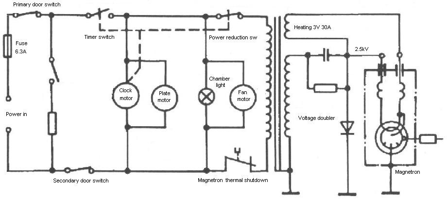

i would like to know how a microwave oven works i mean how do we control the microwave generation and what is magnetron tub?
Any suggestions? Thank you for your time!
Microwawe oven contain a tube, called magnetron. This tube working as oscillator with about 2.5kV anode voltage and 3V 25A heating voltage. The magnetron can run only alwys with full power, and controlled by timers only on-off periodically.
As Sebi has already mentioned, microwave ovens generally use what is known as 'burst fire' power control. They usually use a 10 second timing period, so for half power they turn on for 5 seconds, then off for 5 seconds. It's a method of power control commonly used for heating - obviously not very good for dimming lights though :lol:
I have seen occasional very old microwaves, with just two powers (full and defrost) where they switch a different value capacitor in to circuit for the lower power - but these are pretty uncommon.
THANKS YOU SEBI,NIGEL GOODWIN AND MIXOS FOR YOUR IMMEDIATE RESPONSE. IF POSSIBLE PROVIDE ME SOME MORE INFORMATION REGARDING TO CIRCUIT DESIGNING .
Here is a sematic of the most of case used micro with mechanical timer.
