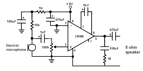

I"m working on designing a project utilizing a closed loop mic/speaker circuit. I'm using a design based on the LM386. I've populated the board and checked for any errors in placement but so far so good. However, when powers applied I'm getting a low frequency oscillating feedback. Following the schematic, I'm getting a solid feedback and if I place a diode between Pin 4 and speaker GND (to block feedback), the signal changes to AC (presumably) and creates a rising/falling type oscillation (signal valley isn't being heard, it just turns off then picks back up while cresting). Forgive some of the terminology, I deal with DC mostly. All components were sourced from Radio Shack. All caps are 35V (excessive given the 9V circuit, but it was the only thing available locally). I've tried a few different variations in teh circuit (diode placement) but would appreciate any feedback. Mic is electret condensor PC mount type, Speaker is standard 8 ohm speaker. Regards.

The circuit looks ok to me.
Please recheck the polarity of the electrolytic capacitors.

Since the problem still occurs with the mic disconnected then the only place where feedback can come from is the power supply. The 470uF capacitor across it and/or the 100uF capacitor that filters the mic supply voltage might be open or missing.

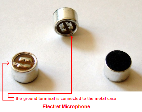

The LM386 set for a gain of 200 has plenty of gain for an electret microphone. Maybe your microphone is not an electret, it might be a dynamic mic (coil and magnet) which does not need to be powered to work. The resistor that powers an electret mic might cause a dynamic mic to have low sensitivity. If the wires on an electret mic are connected with backwards polarity then the sensitivity might be reduced. The metal case terminal should be connected to the circuit's 0V (ground).
The LM386 should produce almost perfect quality.
The LM386 is a power amplifier that has plenty of hiss. If you want a preamp then use a low noise opamp circuit.
Here are photos of a two-wire electret mic. Some electret mics have three wires and need to be connected differently.

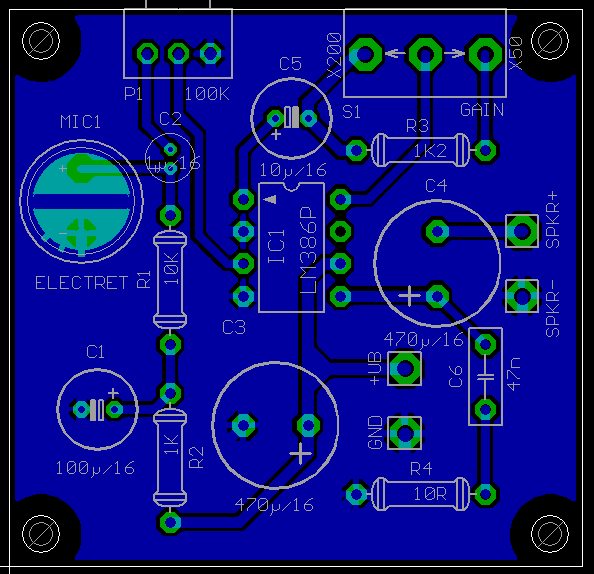

building an amplifier circuit on a breadboard might be problematic because of many unshielded and long wires.

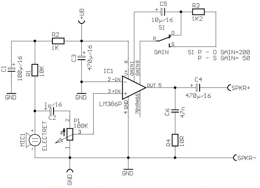

Here's the circuit design with a small add on - a switch to select gains of 50 and 200.
The traces are short and the ground fill takes care of no unwanted feedback.
Boncuk

Thank you for your response. That's more than I could have asked for. I"m going to look into the circuit a little more and determine what's causing my sensitivity issue. The mic is an electret though and the polarity is correct, however I may have an issue with my volume selection circuit, I'm looking for another pot to put in just in case. The first one was something I had laying around and my not be optimal.
Boncuk, do I have permission to use the PCB schematic you provided. It looks like it would be ideal for my application. Also, can anyone suggest a place to have the board propagated, maybe just as a sample to begin with? I appreciate all the help and I'll be sure to help out as well whenever I can. Regards.
Hi twingesabit,
getting the PCB made at a PCB manufacturer might turn out a bit expensive. They normally ask for a minimum board size to carry out an order.
This layout measures 45.0850X43.8150mm (1.7750X1.7250")
May be one of your friends runs Eagle. He might print the PCB layout on matching material for toner transfer onto a copper clad.
Of course you have permission to use the PCB layout. That was it's purpose.
To make it easy I attached the schematic and PCB design as a zip file.

As an update... using the board layout that Boncuk provided I was able to resolve my problems. At this point the pickup on the mic is extremely sensitive and has resulted in temporary deafness. I've adjusted the gain down to the 20 as provided by the op amp but would like to make this an adjustable value. 200 will work in certain situations but for the most part I'd be looking at a range of 80-150 for my application. Would using a trimmer cap accomplish this? If so, what value would I need to look at. Regards.
