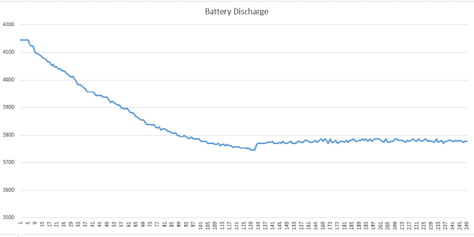

    I am using the Fixed Voltage Reference (FVR) of a 16F18325 to measure Vdd using the ADC using the following code.
    Code (text):
    uint16 Measure_Vdd(){
        uint32 result;
        FVRCON=0b10000101;      //FVR set to 1.024V
        ADCON0=0b11111101;      //adc on and select FVR
        ADCON1=0b10010000;      //Right Justify, Tosc/8, Vss - Vdd as reference
        __delay_us(50);         //delay for settling time of FVR and ADC acquisition time
        GO=1;                   //Start ADC
        while(GO);              //Wait for conversion to complete
        ADCON0=0;               //Turn ADC off
        FVRCON=0b00000101;      //Turn FVR off
        result = 1048576L/ADRES;
        return((uint16)result);
    For anyone interested how this works,
    I set the FVR to 1.024V and feed it to the ADC module. The ADC is set to use Vdd and Vss as the reference.
    The result should be ADCresult = (1.024/Vdd)*1024. Switching this around gives Vdd = ADCresult/(1.024*1024).
    As I want this as millivolts I end up with the equation Vdd=1048576/ADCresult.
    Now, all was working as expected and I was storing Vdd every 15 minutes (running on single Lipo battery).
    Then, yesterday I starting getting readings around 1038 mV without any change to the code.
    I am monitoring the results in Tera term via a USB to RS232 converter and it seems this is the culprit.
    With the converter connected I get stupidly low readings, disconnect it and I get the correct readings.
    Anyone got any theory why this is so?
    I only have Gnd, RX & TX connected but it is still capable of powering the circuit on it's own!
    I'm wondering if using current limiting resistors (22k) on RX and TX might fix this.
    However, I'm still at a loss as to how this is possible. I can't see and change in Vdd using a multimeter and no noise with a scope. It's just completely baffling.
    Edit, The resistors (22k) stopped the serial working completely. The USB - RS232 module is a Prolific PL2303.
    Thanks for reading and for any suggestions.

    I've had this same problem not doing what your doing but the pic powering my usb to serial adapter or the Usb to serial powering the pic and I was only using 2 pin TX to RX and the ground.
    It was giving me a time programming with the pickit 3 I would get a powered target but it wouldn't program only if I really powered it but the pic would run from the rx and the ground.
    I was trying to read the data I was missing so I powered the serial first but as soon as I did the pic word try to run and did. I powered the pic then the serial Id miss the start. It didn't power with a homemade ch340 I made. But I have a old cp2102 it causes all kinds of self powering.

    What is the LiPo battery voltage, Mike? What are the voltages on the USB-to-Serial Adapter Rx & Tx pins?

    The battery is a single cell Lipo (link) so 3.75(my cutoff voltage) to 4.2V. I measured the RS232 pins and they are at 4.6V which means that, assuming 0.7V on protection diode, it will drive Vdd towards 3.9V and partially charge the battery. However, this does not explain the low readings. Having left it overnight storing the value every 5 minutes I get the following chart which suggests all is well and it shut off at the desired 3.75V. But I'm still curious about the RS232 causing low readings.
    Edit Arrgg, The readings stop before 3.75V which means I have a bug which crashed it after 20 hours running. That's not going to be easy to find.
    Edit 2, Seems the glitch in the middle of the chart is it going into standby mode(<3.75V). I thought I only stored the voltage when not in standby. Looks like I have a battery life of just 10 hours but no bug.

    Is there a chance the higher voltage from the USB adapter is somehow affecting the VDD VREF even though it doesn't appear to affect VDD?
    Have you got a USB adapter with 3.3v output levels you can try?

    Tomorrow, I'll try adding a 2k resistor with 5 diodes to gnd to fix the voltage at 3.5V or just two diodes in series to fix around 3.2V. See if that fixes things. Actually, that'll be Monday as girlfriend will be upset otherwise.
