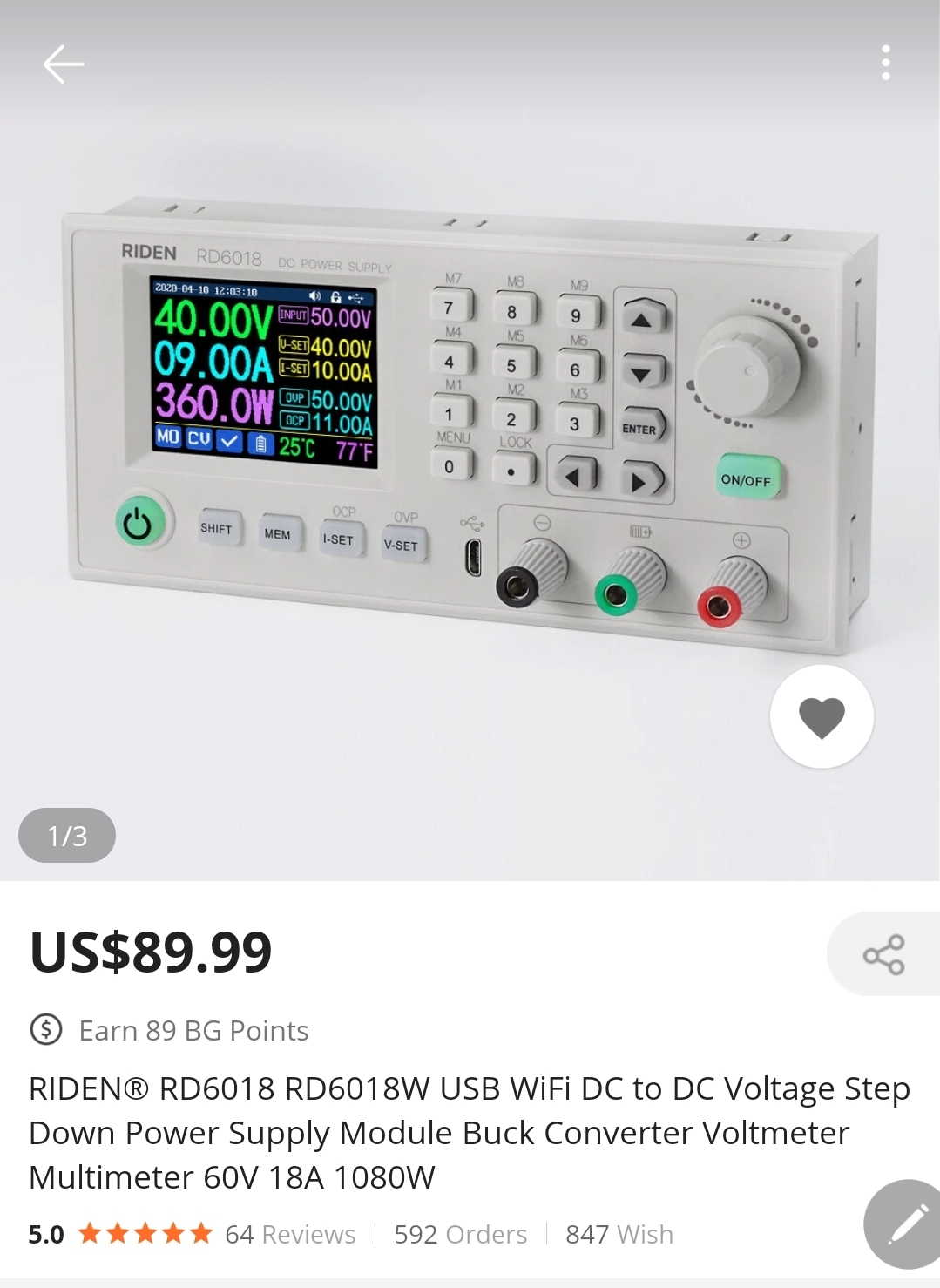

For me, this kind of supply is hard to beat. I have the 6 amp version, but the latest is 18 amps.
These are actually buck controllers. You supply DC to it at up to 60 volts and 18 amps (in this case), perhaps with an open-frame supply, and this module regulates the voltage or current, with plenty of bells and whistles.
Nice whats efficiency of this ps? Can it really source 1kW? Its relatively tiny.
I have the 6 amp version and it seems to be an honest spec. They have an enclosure for it that holds an open-frame power supply and it has a fan for cooling, which is necessary at high loads.

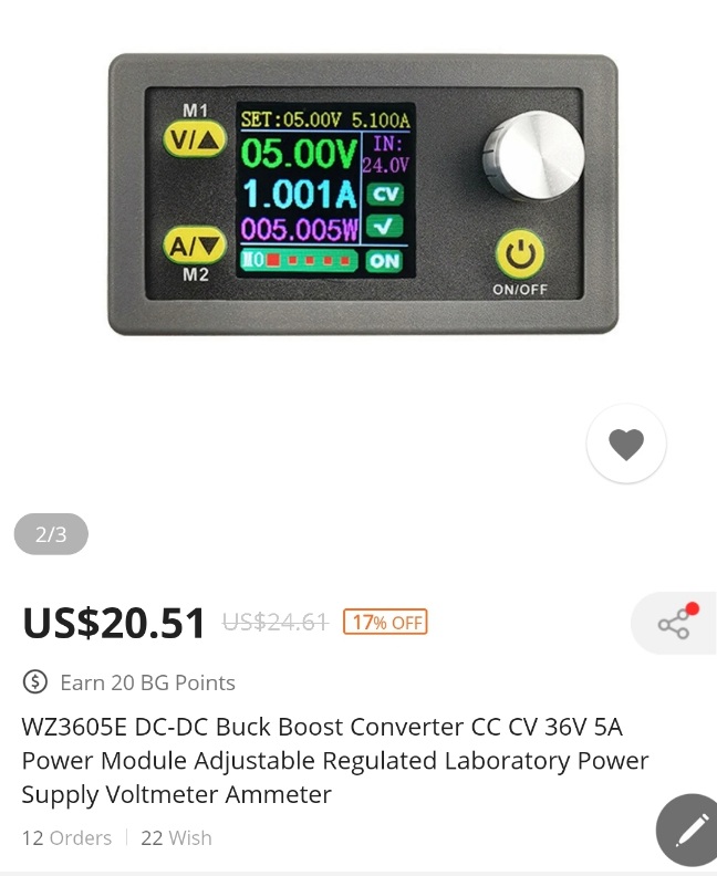

Seems like with all the power supply options coming out of China, there's not much room for a low-volume variant. The Riden family of supplied that I mentioned above is very full-featured for the price. Smaller versions, like the one shown below, bring the same features at a lower price, and clones are available for half the price.
You might want to search "power supply module" on Banggood or ebay, and see what you're up against.
