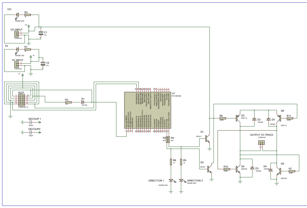

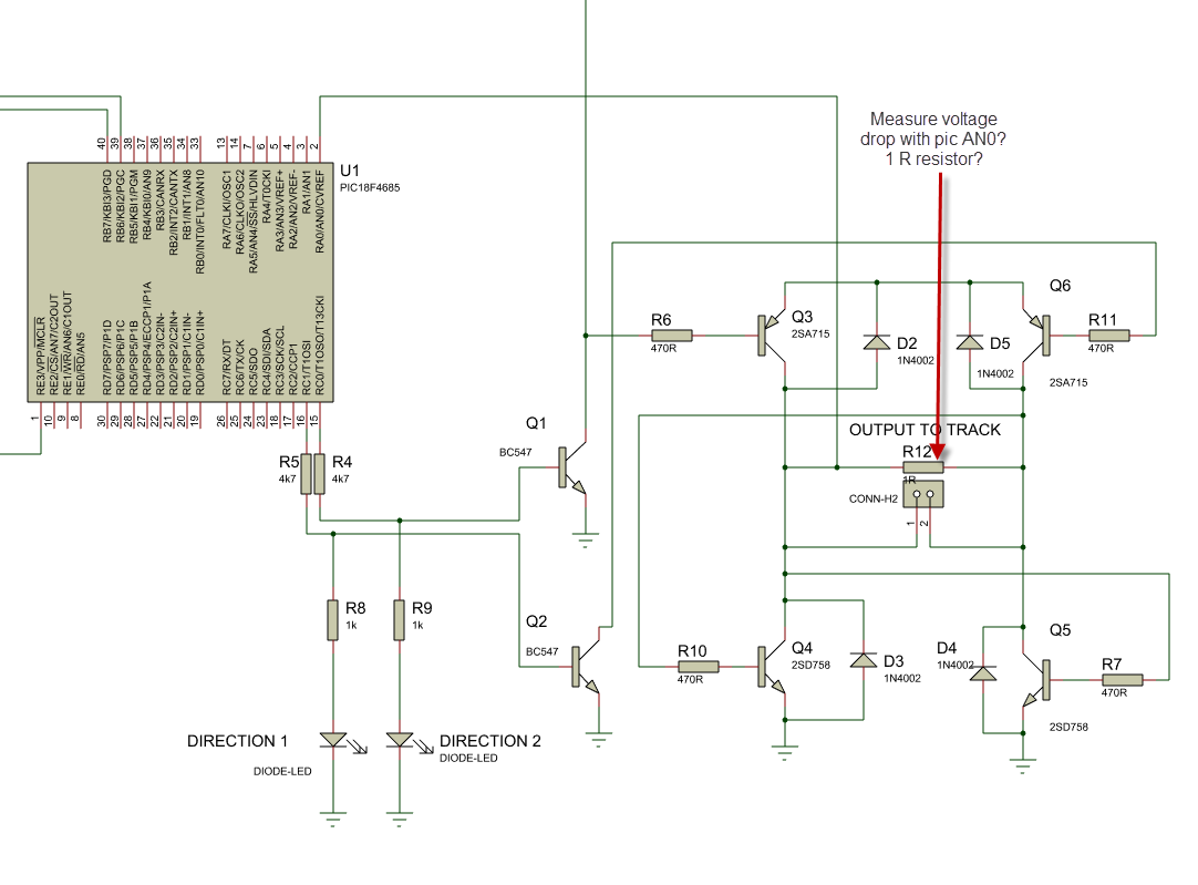

hi all, i am working on a large, model railway layout, it has in excess of 200 electricaly isolated tracks. the plan is to drive theese sections of track with H Bridges using pic's and probally shift registers, however at the moment we also have a small oval 'testing track' with wich we are trying out various control methods etc. the following is a overall schematic of the H Bridge design we intend to use (please note ignore the transistor values on the drawing as theese havnt been decided yet so i used generic for the drawing).
now my question is... we want to be able to measure the current being drawn from the H bridge output from the track section, i have discounted things like high side chips etc due to the large number that would be needed eventualy, so i wondered if i conected a resistor as shown in the second drawing and conecting to the pic's AN0 would i be able to read the current? the exspected range of current would be from around 100ma to say 2.5-3A.
is this possiable or if not how would i do it?

I do not see where R12 and measuring voltage will give you any information.
I hope the emitters of Q3 & Q6 go to a supply.
If you disconnect the bottom transistors emitters from ground and connect them through a single 0.1 ohm resistor back to ground you can get a feel of the current flow. Connect AN0 to this point through a low pass filter to remove the AC noise. 0.1uf from AN0 to the micro's ground. 1k resistor from AN0 to the top of the 0.1 ohm resistor. 1V=10 amp. Your 0.1 to 3.3A will show as 0.01 to 0.3 volts.

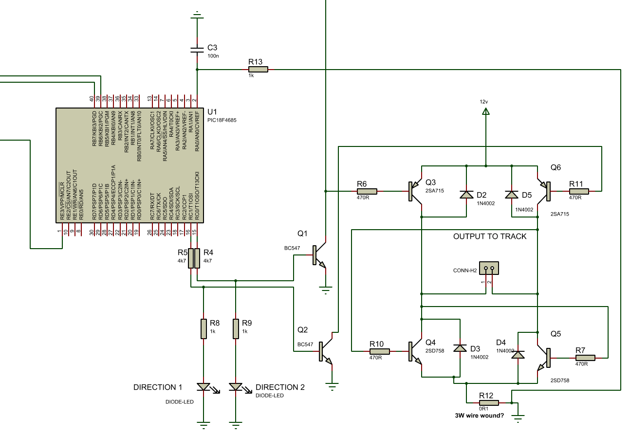

thank you ron thats realy helpful advice!! infact no i didnt have the emitters of Q3 and Q6 connected!!! i will correct this thank you for spotting it! i will redo the drawing and repost so it can be checked. that deserves some quedos points me think
Put the sense resistor in series with the connection to the track and measure the voltage at both ends of the resistor.
Then current = (V1 -V2)/R.
Or put the resistor between the common connection to Q4+Q5 emitters and the 0v return to the supply.

ok i think this is what was meant tho i confess to not getting the meaning of top and bottom of the resistor!! (sorry some stuff just dosnt get through to me after the stroke)
thanks for the tip jim i will be using pwm so will take the reading from AN0 when the signal is high on the pwm, also will a 0.1r 3W wire wound resistor be ok?

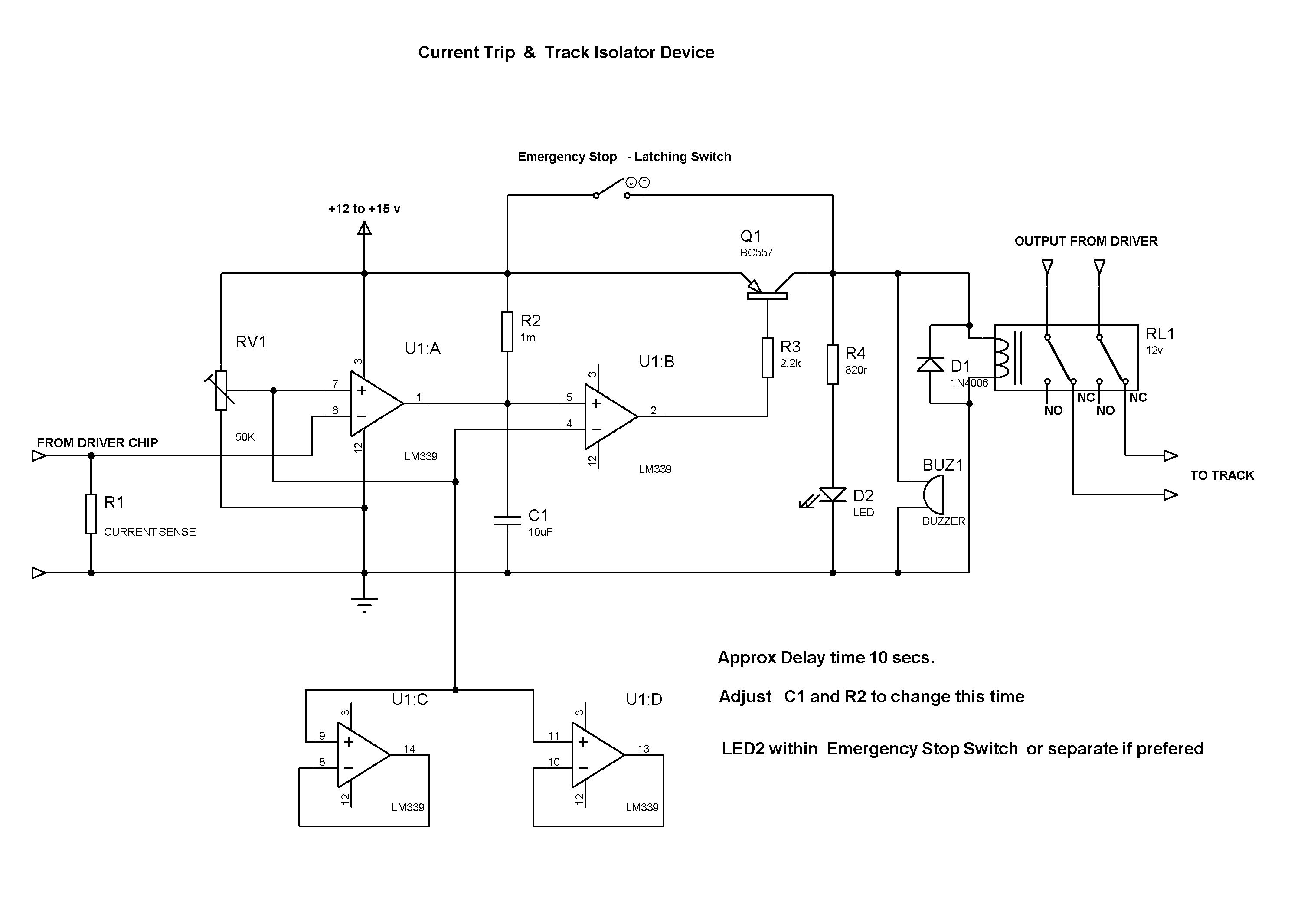

Assume you are designing a dcc system ? - you might find the voltage from the sense resistor quiet small and very prone to spikes that will need a lot of 'conditioning' by your adc routine.
I built this simple circuit for a 4 channel dcc diy system, the emergency stop switch is essential.
Until you see it, if a fault develops and full power sent to the loco it literally takes off the track .
You might want to try building it and scope the signals so you can see what you are dealing with.
Interested to know what your 200 separate tracks with 200 H bridges are for ? something that big would have thought you need to use a well proven system ?

hi wp, the system isnt strictly speaking DCC, its a huge layout tho and the tracks have been isolated in many place's. the H bridge in the diagram is just for testing a couple of thing on a small oval circuit 8' x 4', its kind of a see if this works sorta thing . so i take it the diagram is ok to go ahead and board up?

Back in post #5, R13 should connect to the top end of the current sense resistor not the ground end.
cheers ron i had a dopey moment!!! good job i dont play with tesla coils lmao
