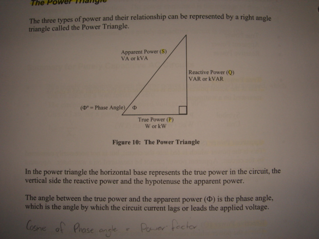

Do you have a formula for the power factor?
I do:
See attached pictures
