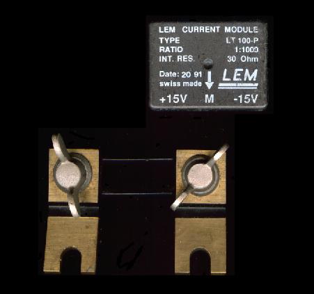

I have a commercialy built 50A shunt which gives 50mV at 50A, so its resistance is 1mOhm.

The other one is a 30mV/30A shunt.
on1aag.
  • LEM LT+100-P+E.pdf

this is the shunt that i have for monitoring the current drawn from my batteries in the back of the works van. Its rated 200A/75mV

4-wire sensing:
In Weegee's picture above of a high current shunt, the two small screws are where you attach your voltage measurement wires and The 2 large screws are where you wire the high current wiring. Hense 4 wires.
