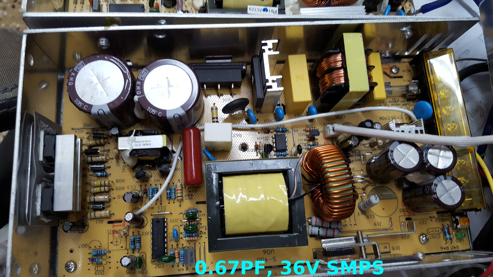

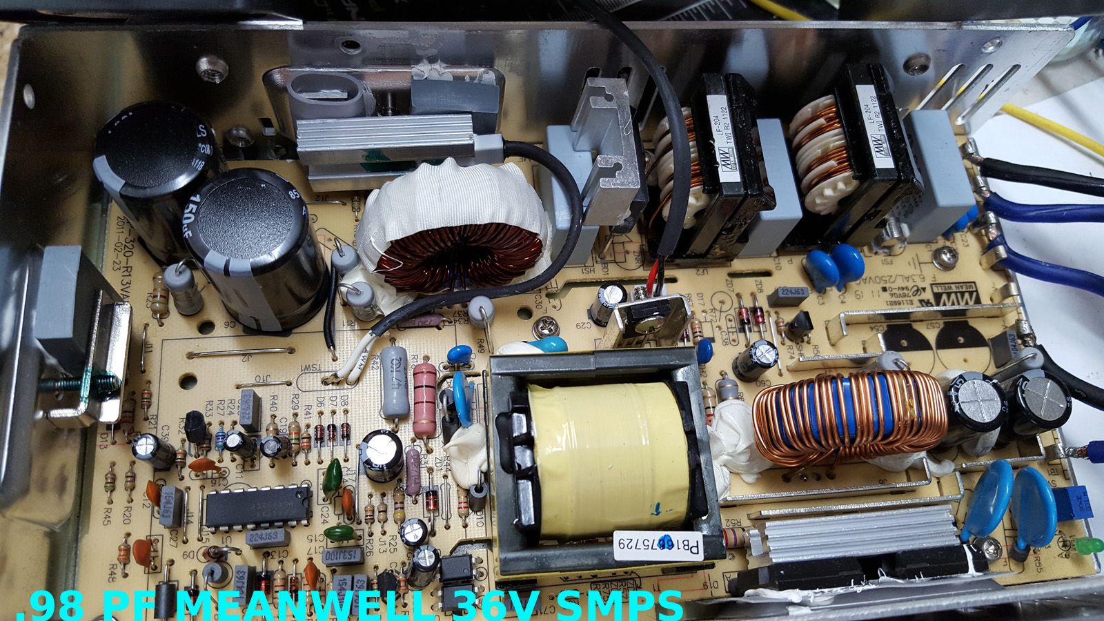

The cheap ($25) 36V PSUs @ 350W deliver around 0.67PF compared to .98 from the Meanwell PSU. In actual terms the calc works out to about 1.5x the power consumed by the cheap unit compared to the Meanwell for a given output.
Also since the MeanWell has no 115/230 V switch and the cheaper unit does....does this mean the MW unit is compatible with 115 to 230VAC al the time?
BTW I am using a Kilawatt unit to assess the power consumed, PF etc.
I think #7 above confirms Schmitt's statement earlier.units employ an active power factor correcting stage,
Hmm, the Killawatt unit reports 1.5X the wattage being consumed with the low PF unit and shows more amps as well, but similar VA.
