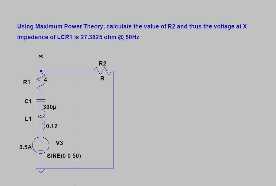

According to maximum power theory, maximum transfer occurs when input impedence = output impedence. As represented in the image below, the combined impedence of LCR1 should equal R2. At this point X is the ideal voltage level.
The generator is 0.5A variable voltage (I may have used the wrong symbol).
I calculated LCR for various frequencies but for this example it's 50Hz. You can see that I computed 27ohm which is about 13V. This matches my expectations.

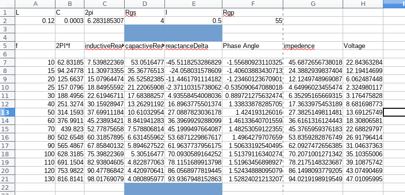

I then created a spreadsheet to see how changing the input impedence would change. You can see that for this capacitor selection the lowest impedence is at 25Hz.
Which suggests the highest power extraction occurs at 25Hz when R2 is lowered so that X is 2.32V. This is much lower than I was expecting, but could be right.

Is the driving source a current-source, or is it supposed to be a voltage source?
If it is a current source, then the power delivered to R2 is dependent only the value of R2 (R2*I^2).
If it is a voltage of 0.5Vrms, then the maximum power transfer to R2 occurs when R2=4 Ohms at a frequency of 26.36 Hz.
I swore I wrote a line which said I'd used the wrong symbol. It's a current source, fixed 0.5A.
The delivered power also depends on the impedance of the source., which is what maximum power transfer calculation is about.

Where did you learn that theorem? You have completely misstated it. If the source impedance cannot be changed, then the maximum power transfer occurs when the load impedance is the conjugate of the source impedance. If the source resistance can be lowered, then more power will be transferred, even if the load impedance is not changed from its previous value. The maximum power transfer occurs when the source resistance is zero.
Voltage is measured in volts (V), not amps (A). What kind of generator is it?
You got two things going on here. The first is the current changes caused by the inductance and capacitance when the frequency changes. The second is the load distribution determined by the source and load impedances . A resonant frequency will enable the source generator to output the greatest power. Otherwise, the capacitor will inhibit the power at low frequencies and the inductance at high frequencies. If that is a current generator you have, it will have to be a monster to punch 0.5 A through the cap at low frequencies or the coil at high freqs.
I don't see any figures for power transferred, so I guess it doesn't mean too much.

Well, now that we know you have a 0.5 A current source driving things, we can deduce that there is no maximum or minimum transfer of power. The power transferred will be i^2 tunes R2 no matter what the the source impedance or frequency is. The voltage at "x" will be I times R2. That is because no matter what the source impedance is, 0.5 A will always be present through R2.

You are missing a very important point. Since I1 is a current source, it forces 0.5A through the circuit regardless of what the impedances of L1 and C1 are!
Look at I(R2) and Power(R2) vs freq from 1Hz to 100Hz:
Now look again at a fixed frequency of 20Hz but with R2 varying from 1 Ohm to 100 Ohms.
Notice that power in R2 is proportional to value(R2), so the max power in R2 occurs when R2 is infinite.
If the source is a 0.5V voltage source, I can tell you by inspection that the maximum power in R2 happens when it is 4 Ohms and when the frequency is such that the reactances of L1 and C1 are equal.

But a current source has an infinite impedance so the output impedance would also need to be infinite for maximum power (which in this case would also be infinite).
You need to work with a voltage source, not a current source.

It doesn't have an infinite impedance though - it changes it's impedance based on frequency and inductance, which I phase correct (as best as possible) using various capacitance values. The calculated figures are in the spreadsheet.
  • impedence.xls.zip
The equations used in the spread sheet do not reflect the reality of the circuit topology.
It is a series circuit fed by a current source. That means that the current in every element of the circuit is determined only by the the magnitude of the current delivered by the source.
You cannot change the fact that 0.5 amp of current is present in R2 no matter what frequency you drive it with or how much reactance you put in series with the current source. If the current does not change, then neither does the power transferred. You defined it to be a constant value, so the power transferred must be constant also, unless you change the value of R2. Keep in mind that the power associated with the reactance voltage goes back and forth to/from the source generator and not to R2.

That's the impedance of the network in series with the source, not the current source, which is infinite.
Max power transfer is when the output impedance = input impedance, values on the spreadsheet.
No.
You need to better understand what a current source is.
It generates a fixed current, independent of any other element in series with it, thus the value of the network impedance has no effect on the load power.
