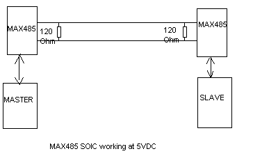

Hello,
I was reading its datasheet carefully (Max485 SOIC 8pin) for a tight speced application . But I couldnt see how much current driver consumes while transmitting? Absolute maximum provide a 471mW figure .

Ok I just want to know how much current is MAX485 consuming maximum?
Hard to say, it will depend on the 485 network load.
I use only two ,1 Master and 1 Slave a total of only 2nos MAX485 terminated with 120 Ohm resistors . Any suggestion on current consumption?
