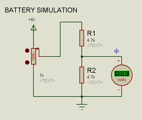

Oh I get it. The current limit a PIC pin can handle is until 20mA. Here's my simulation below. I've followed your suggestion Nigel. I'll use it for a 4-bar battery status so I really need it to be ADC. Will my PIC be in good hands? :)
btw, If 1.5v alkaline batteries wont function at 1.2v and considered dead on most applications what about 6v Sealed Lead Acid battery? :D

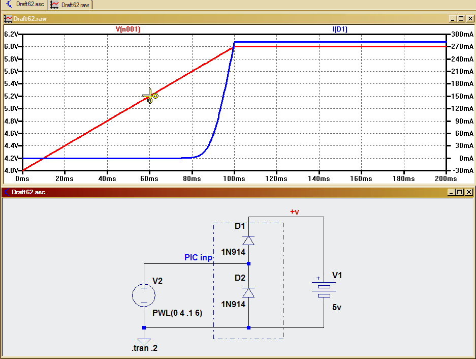

hi Nigel,
Depending upon whatever else the +5Vs is powering in addition to the PIC, the power/current for the total circuit would flow thru the PIC diode,
because the projects +5V regulated source would 'shut off' .
A LTS sim shows the way I think it will work.

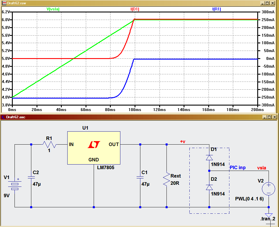

hi Nigel,
You're assuming it's powering other higher current items on the same rail - which 'may' possibly happen, but it's probably more likely not.
I would think it will more likely that the +5V will be powering other circuitry, having seen some of the Forums project offerings.
Whatever ever the case, we both agree, dont connect low impedance over voltage/current sources directly to a PIC I/O pins.
OT: has the weather improved enough to enable the country walks.?
EDIT:
To clarify the points we are making, here is a sim showing how the current supply source is switch over.
I'm so confused now :confused: :confused: really sorry. I'm using one 12v lead acid battery to power my circuit and one 6v lead acid battery to power my motor. Thank you for the simulation, I really wanted to understand them all especially the graphs but I think I have to review my electronics again to understand them all fully. Please confirm if the two 4.7k ohms voltage divider resistors are good. :( Sorry for the headache.

I understand from what you have said, that the PIC will have a +5V supply from a 7805 voltage regulator.
This means that for you safely sample the voltage level of a 6V SLA you should use a resistive divider from the 6V battery and 0V, take the junction of the divider resistors to the PIC's analog input.
What is the maximum voltage that the 6V SLA can be at, example: will the 6V SLA ever be connected to a charger while you are monitoring it,???
I'm not connecting any charger on it. The circuit's use is to tell the user that if the battery is on its low voltage then it should be removed and should be charged right away. So is my two 4.7k resistors in parallel setup fine?
Its two 4.7K resistors in SERIES not parallel.
So the centre of the resistor divider will be 3V when the battery is at 6V, which is OK/
I'm sorry. What I mean is that, the ADC input is in parallel. Is it okay?
Yes, its OK.
If you assume the 6V SLA needs recharging when the voltage drops to say 5.5V , that would be 2.75V at the adc input.
Yes. :)
