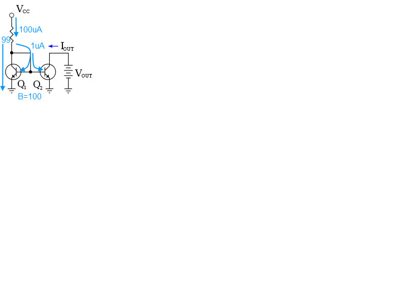

OK so you have never studied current mirrors.
There are two or more ways to explain current mirrors. I could take a page with many numbers. I will use the method with little math.
See drawing. If we do not have Q2 then; current from Vcc passes through the resistor and into the base of Q1. (current gain = 100) The resistor limits the current to 100uA. 1uA in the base will allow the transistor to pass 100uA in the collector. Cruddy speaking 1uA in the base and 99uA in the collector. "Why the C is tied to the B". Well at first all current went into the base which turns on the transistor until the C steals away most of the current. (The C can pull down to a point it takes most of the current)
Now add Q2. If the Vbe is the same for Q1 & Q2, then Q2 will also get 1uA. Now Q1c=98uA. Q1B=1uA, Q2B=1uA and thus Q2 will turn on to the point Q2C will be 98uA.
This current mirror are every where. It is used in ICs. You will find many in a 741 op-amp. The transistors are made on the same die and thus will have matching Vbe and matching B.
I don't have time to explain well the circuit from TI. The Vbe does not have to match. (I think it is matched "OK" because the two transistors are on the same die) Even if they are not matched the TI circuit will not be effected too much. In the TI circuit there is a 1 ohm resistor between the two emitters and current flow through the LED will cause 1 volt difference between the emitters. There also is a 499 ohm resistor in one of the emitters. With one volt across the 1 ohm resistor the transistor pair will force a equal 1 volt across the 499 resistor to match. (any time you add emitter resistor to a 'current mirror' you decrease the need for Vbe to match) With out the resistors a 1mV mis-match will have a effect. Now with 1 volt across the resistors the 1mV error will be about 1% error. I don't have time to do the math but the Vbe effect is greatly reduced by adding resistors.

I have to say I don’t recognise the MMDT5401 (dual PNP current monitor) circuit as a current mirror, because the current in the reference branch is not equal to the current in the “mirror” branch?
I am familiar with adding resistance to effect “emitter degeneration” in current mirrors that are attempting to equalise, for example, parallel LED currents, but the useage seen here (in the top post circuit) does not seem to tally with that use.
