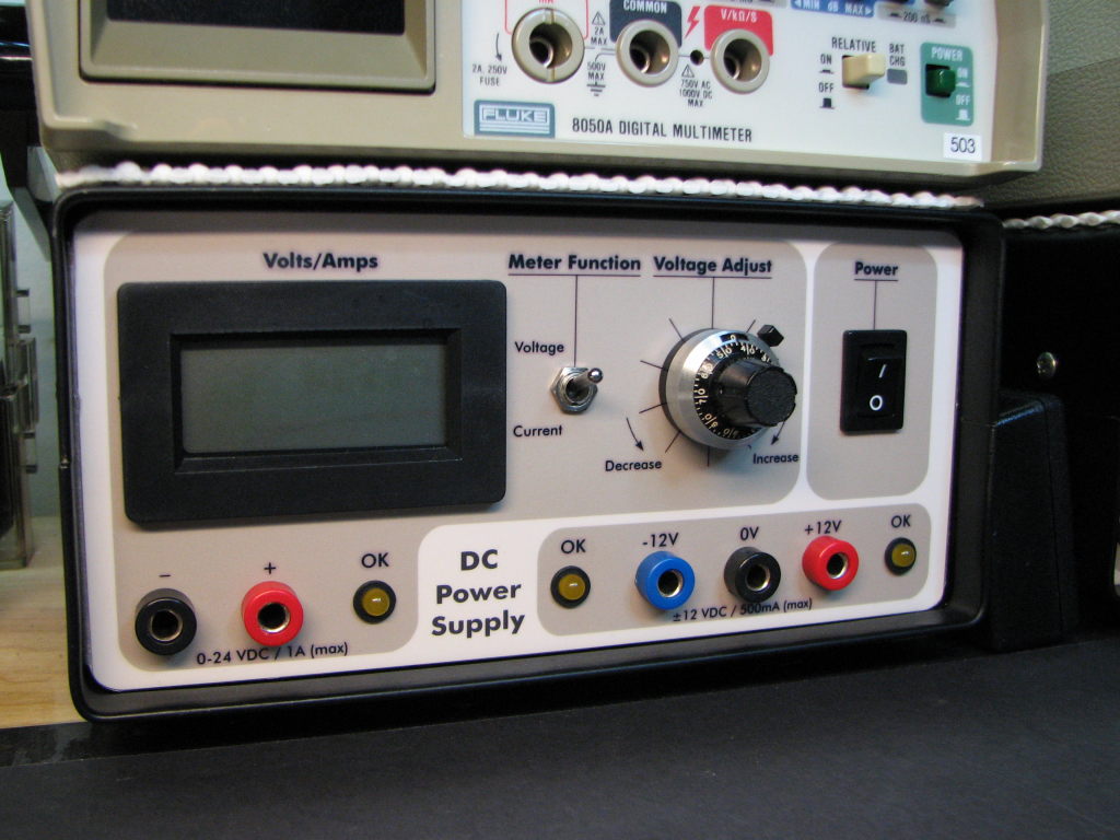

I use a bubblejet printout on photo paper and cover it with frisket film, then attach it with spray adhesive (3M 77). It looks pretty decent regardless of what kind of junkbox engineering I have inside.
As a plus, during construction I temporarily attach a draft of the front panel graphic to use as a drilling/cutting template. Beats measuring and marking.

Wow, very professional appearance. I've also done something similar with overhead transparency film and 3M 77. It works best with a light background, like aluminum.

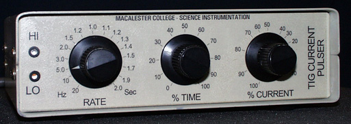

Ken

WOW....that equipment looks like store bought, ok ok ............scrub the label machine, i'm gonna give the bubblejet printer a bash, not the printer, i mean the idea, it must be way easier to make the lines and the text has gotta be a breeze.

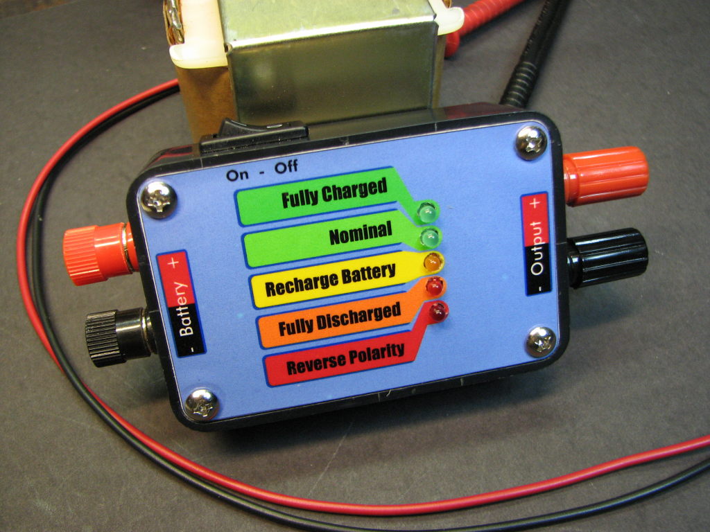

Yep, you can go crazy with colors and lines and such. Here's a smaller example, a 12V battery monitor in a little Radio Shack box.

Wow thats nice!
I have used Frisket for paint masking designs. How durable is it long-term?
