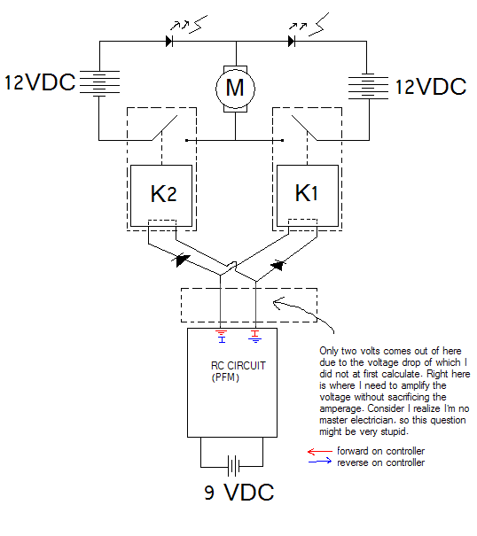

If you've ever watched battle bots or robot wars on the television, then you'll understand what this is. I'm using diodes and relays to use a small 9 volt rc circuit to power a large DC motor with two 12 VDC batteries.
Now, the power coming out of the PFM circuit (remote control, PFM meaning Pure F**king Magic) is only two volts, ant I need more power to actually work the relays. The problem is I can't add more power to the PFM circuit because I might fry it since it's little and cheap. I remember from my "tech core" class back at my old training command (I'm a radar tech in the Navy) that transistors were a great way to amplify power, but it's been quite a while. If anyone has any advice I'd be most greatful.

You are going to need to use the PFM outputs to drive the gates of some MOSFETs where the source and drain of the MOSFET transistor (an NMOS specifically, just makes things easier rather than a PMOS) where the NMOS's source is connected to ground and the NMOS's drain is connected to the one end of the relay coil (The other end of the relay coil is connected to the voltage.
It is similar to using the PFM output to drive smaller relays that can be turned on by 2V but can pass larger currents that are capable of turning on your main relays.
It MIGHT work since 2V is pretty low and you would have to pick a low threshold MOSFET whose gate can be triggered with that voltage.
Add diodes in ANTI-PARALLEL with the relay coil so that the voltage spike produced by cutting off current flow through the inductance int he coil when you turn the thing off won't destroy your transistors- anti-parallel meaning in parallel with said coil, but not so current can normally flow.
Just like the transistor and motor in this schematic:
except that your PFM circuit is driving the gate instead of the 555 timer on the left, and the motor is your relay coil. THis diagram does not show the high-speed low voltage diode (like a schottky diode) that should goes in anti-parallel with the inductive load (the motor in the schematic or in your case your relay coil) to give the inductive flyback current a path to flow when cutting power to the coil, otherwise it will give the current a path to flow by producing a voltage spike until something gives.
Obviously the voltage "above and below" the drain and source of the transistor is the voltage required to turn on your relay coil, and not the voltage of needed by your motor itself (that's somewhere around the primary terminals of your relay)..

This should get you going:
Q=2N2222. Should be good up to about 100mA
