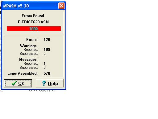

Hi to all,
I was planning on making a PIC Dice for my young grandson and found a program that looks just the job.
Unfortunately its for the PIC12F675 and I only have some PIC12F629s.
The datasheet covers both PICs and the only difference I can see is the 629 not having any Analog capacity where as the 675 does.
Would this program work on the 629? Because its in ASM I can't figure out what does what. I only know Basic so could anyone out there check the code and see if anything needs changing please.
Thanks for looking.........Al

If what you say is true; PIC12F675 almost equals PIC12F629, I did not check, then:
Change the #include line and compile. See what errors you get. If no errors then go for it.
The include file describes the part. You could compare the two files.
Have a look at this extract from the code:
_intvect
_main
	bcf	STATUS,RP0     		; Sel Bank 0
	movlw	0x07		;
	movwf	CMCON		[COLOR="blue"]; Disable Analogue on GPIO pins[/COLOR]
	movlw	b'00001001'	               ;
	movwf	INTCON		; Enable GPIO state change int
				; See 12F675 data sheet P19
	bsf	STATUS,RP0     		; Sel Bank 1
	call	0x3FF		; calls RETLW with factory setting
	movwf	OSCCAL		; Set int OSC to factory calibrated
	clrf	ANSEL		[COLOR="blue"]; Disable Analogue on GPIO pins[/COLOR]
	movlw	b'11101000'    		; Specifiy GPIO port direction
	movwf	TRISIO		; Set GPIO ports as xxIOIOOO
	bcf	OPTION_REG,NOT_GPPU	; enable weak pull-up
	bsf	WPU, 5		; enable wpu on GPIO 5 only
	bsf	IOC, 5		; enable Int-On-Change GPIO 5
	movlw       0x20			; set up 20mS wait
	call        _Delay			; after reset
As micker just posted above the analogue commands aren't needed so the

Hi Eric,
No, I don't think the errors are the same as you thought, here is the screen grab, have a look.
Mine does not assemble at all, but yours does fine. Still baffled

For that many errors the compiler / assembler can't find the "p12f629.inc" file. Look at the actual errors, if the first error is "can't find p12f629.inc" then all the errors will be related to that!
Cheers Ian
Cheers Ian
Hi mate,
Can't get as far as an error file. Its not creating one.
Al
Ahhh! If there is no error.log in the working directory then the output path is incorrect OR the error reporting is turned off. Find MPASMv5.20 and run it (you can assemble directly from within by browsing the file) then you can set all options required on the interface.
Cheers Ian
Why not install MPLABIDE 8.60 ?
hi Al.
How are you running the MPASM.??
You should see an options window./
As suggested by Ian, the quick/long term fix would be to download the MPLAB IDE, its free from microchip.
Thanks guys,
I will download MPLAB IDE and give it a try, then report back.
Thanks again Al
Hi Al,
when you have MPLAB IDE installed successfully, you can find MPASMWIN.EXE in the following location: (Assuming you installed using the default paths)
C:\
Program Files
Microchip
MPASM Suite
All the .INC files are in there as well.
Create a shortcut to MPASMWIN.EXE and drag it to your desktop, or another folder if you don't want a messy desktop like mine, then you can simply assemble a .hex without having to load MPLAB IDE, by simply using the shortcut instead of opening MPLAB and creating a new project, then adding the necessary files.
Quite handy for when you have downloaded a working .asm file and just need to assemble it to produce a .hex file.
HTH.
