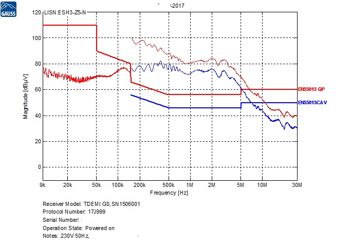

We are testing to EN55015. We have failed badly across the conducted band of 150khz to 30MHz. Seems a bit strange given that our 150w offline led driver is not an SMPS based one, but just gently switches in/out led banks as the mains half cycle rises and falls.
We failed with no EMI filter in circuit, because we wanted to see how good/bad it was because we think we should be able to get away with a small filter because we are not using a switch mode....thing is, we cant afford to keep paying the EMC test house every time we modify the filter and need a re-scan.....we need to do something ourselves first as kind of a pre-test.......we have the test house plots for our luminiare with no filter, so we are reckoning that if we build a LISN and get the same plot as the test house, when no filter is there, then we have a good LISN (if it gave the same plot as the test house then it would obviously be good) ....or good enough. We would like to buy a LISN, but cant affird the £1000 for a HM6050.

I have a home made lisn and old test equipment that was last calibrated many years ago. (calibration report on clay tablets)
I do not look at "numbers" or db. I take the lab's report, like the one you have. If they say it is 3db too high at 150khz then I find a way to bring down the reading at 150khz with out pushing some other point up much. (I use relative numbers not actual numbers) My test machine might be -5db at 150khz from calibration but I don't care. I just need to move the line down by 3db.

Thanks, the following shows how badly we have failed the EMC scan. -Across the entire band, which seems remarkable when there are a couple of led banks that get gently switched in and out twice every mains half cycle....and no high frequency switching power supply....of course, this scan is with no filtering whatsoever.
If I remember right you are slamming the LEDs into the power line with out any inductance. There might be some real current on the switching edges.
