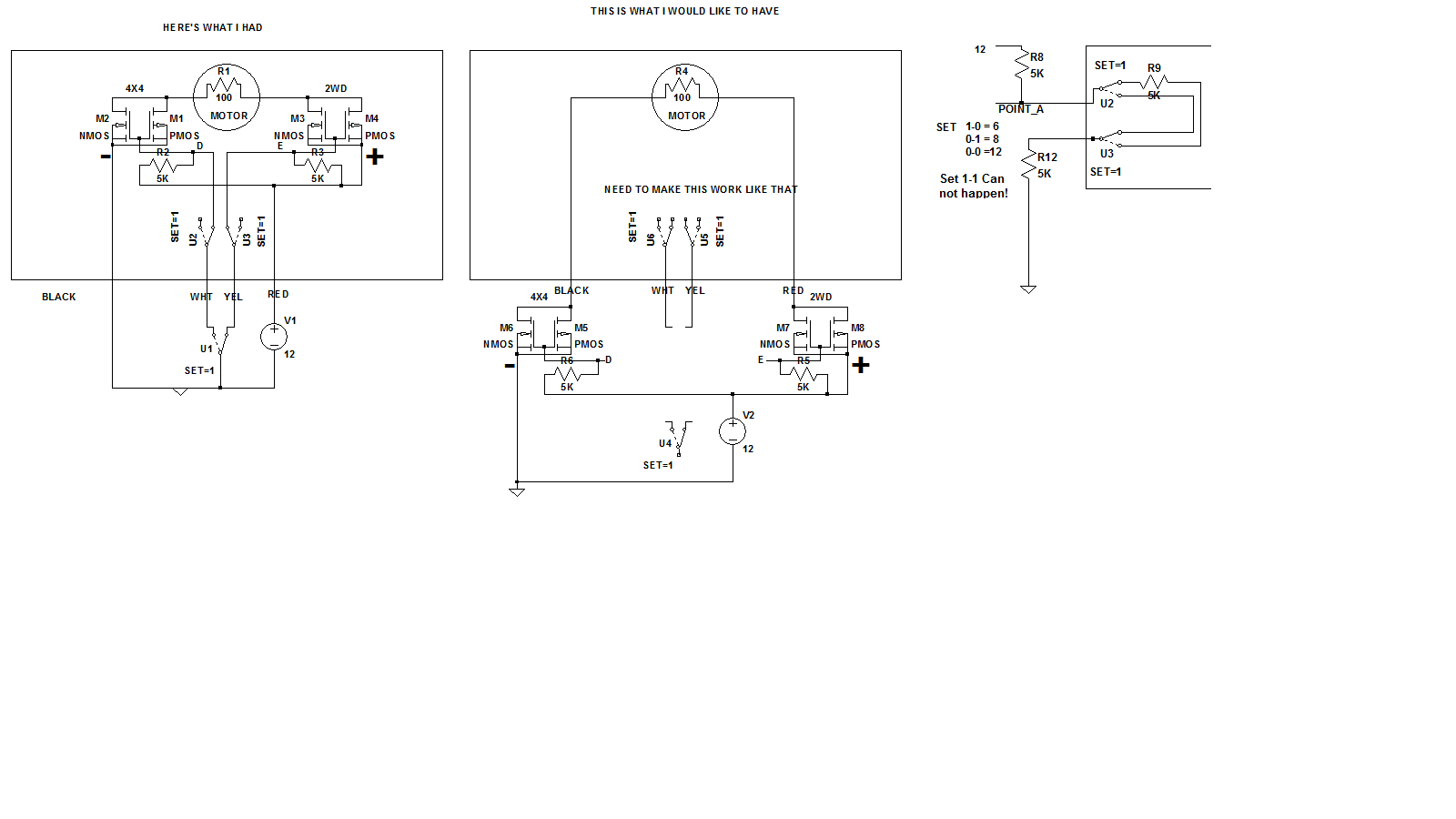

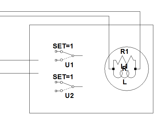

I have a linear motor that fried part of the circuit board and I am trying to modify it. It has 4 wires coming out, 2 will be for the motor driven by an external H-bridge and 2 for the end of travel switch which is 2 spdt limit switches. I have a spdt switch to choose whether the motor is extended or retracted. What I need it a method to that works as if I had 3 wire.
Any suggestions that aren't too complicated, maybe a 555 or voltage divider. As I see it, I have 3 positions, extended, retracted, and travelling.
Thanks,
Kinarfi
PS. The H-bridge has both NFETs turned on and both PFETs turned off because Vgs is + on all FETs and to drive the motor one way or the other, one side of the H-bridge it tied to - and the end of travel switch removes that - and only the NFETs are turned on again.

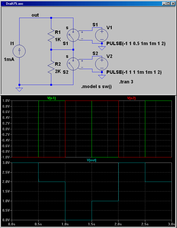

How about a rudimentary DAC? Obviously, the 1mA current source is at the readout end, while the resistors reside with the two switches.

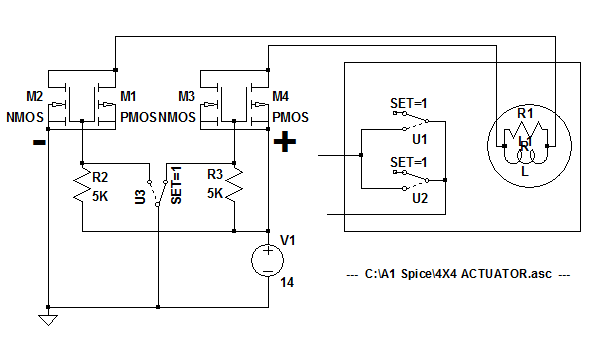

Still trying to figure this out, problem seems to by making it park, end of travel reached and U 2 or U 3 activated, and being able to switch U 1 and getting it to travel back and park again and then switch U 1 again and have it travel, then park.
I can get 3 different voltages across yellow and white, just need to figure out how to use that.

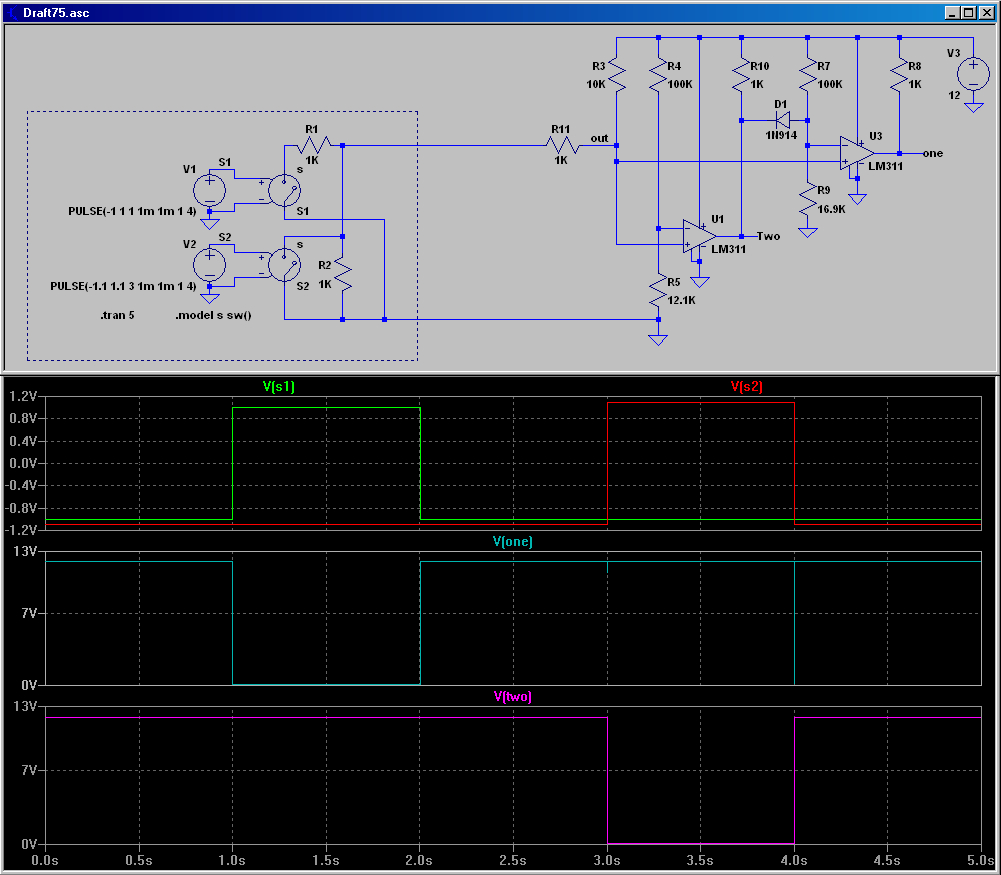

Here is a version that has only three states of the two switches: Both Off, S1 On, S2 On, but never S1 and S2 both on together.
I'm using two comparators to detect the three states. The outputs at "one" and "two" go low depending on which switch is closed. Load resistors R8 and R10 could be replaced with a small relay because the LM311s will sink up to 50mA.

Thanks Mike,
Kinarfi

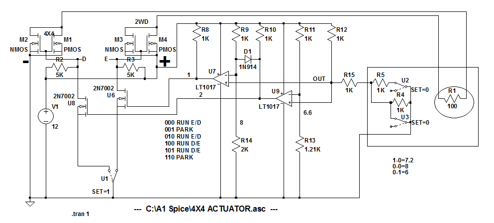

Looks like it should work perfectly, a bit more involved than the original, but a design I will keep for when I need to do similar things. I was close, but the diode is what made the difference.
Thanks again,
Kinarfi
