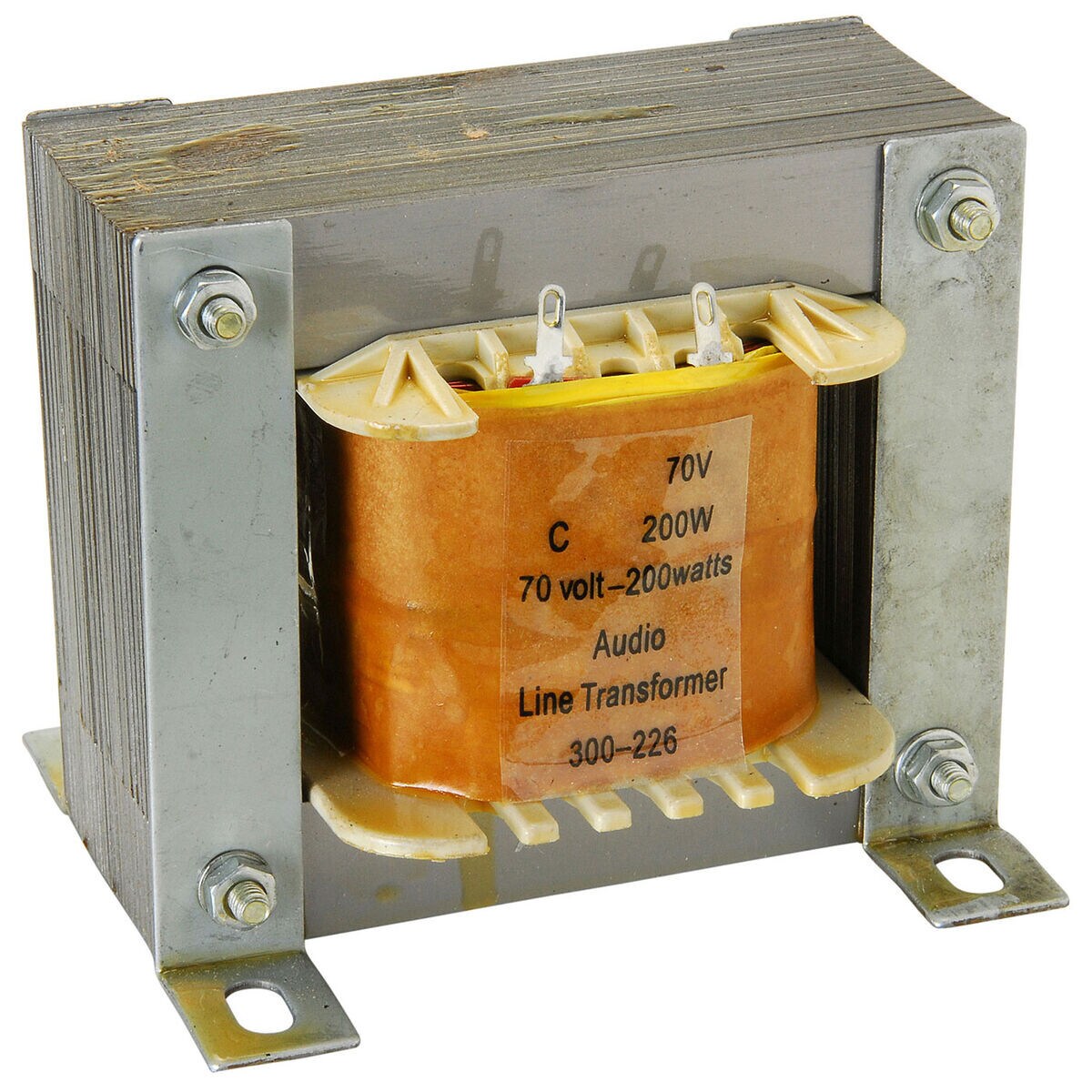

As ChrisP58 said in the first reply to this thread, high power audio transformers exist; both line matching and just amp power output.
They cover a vastly wider range than 50-400Hz and do not have particularly large cores or ultra-thin laminations, compared to 50/60 Hz transformers of similar power, even though they can be rated to 20KHz or more.
Example: 200W, roughly 4x3x3"

No, it's utterly pointless - you 'could' design a steel core transformer to do so, as the vast number of audio transformers show it's easily do-able. But as the point of a 400Hz PSU is to make the transformer smaller and lighter, why would you?.
As everything now is switch-mode, using MUCH higher frequencies makes supplies far smaller, lighter, and efficient in any case.
BTW, an audio transformer isn't really any different to a 50Hz mains transformer - and in these days of EXPENSIVE valve output transformers it's quite common to use a suitably chosen 'off the shelf' mains transformer in place of one. From that I would assume a 50Hz transformer would happily work at 400Hz?.

As has been said throughout this thread, it's not an issue, as audio output transformers go from 20Hz to 20KHz with no problems - and it's now common practice to even use cheap mains transformers as output transformers in small valve amplifiers (easily available, and much cheaper).
I imagine the only issue is having a big enough transformer for the lower frequencies?, so a 50Hz transformer will be fine higher (to well above 400Hz), but a 400Hz transformer wouldn't be happy at 50Hz as it's too small.
I imagine using them for audio use, you simply get a more powerful transformer than you need, and that will extend your bass response to less than 50Hz.
I would expect mains transformers to have significantly higher distortion and poorer frequency response than audio transformers, but I suppose those that want a tube amplifier, aren't particularly concerned about such things. :rolleyes:
Exactly, quality from valve amplifiers is relatively low anyway - but what's the difference in the transformers?, it's basically copper windings on a similar core, and negative feedback will help reduce distortion etc. I suspect if you were looking for push-pull and ultra-linear, it would be a very different story though :D But as you're unlikely to find such a suitable mains transformer, it's not really an issue - but for single ended it should work fine.
