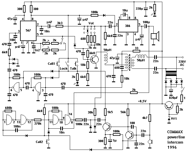

How do they do that? I would think that the 120v would totally kill the electronics but there must be a way.
They generally use FM, injected onto the mains, via isolation caps and filters. The higher FM frequency passes through the filter caps, and the 60Hz AC is blocked.
ahh, that makes quite a bit of sense.
This would nesecitate capacitors rated for mains voltage i would imagine. About what value of capacitors?
Does anybody know of any schematics on the net? I searched google and couldnt find anything.
I haven't seen any designs for years, they used to be popular in the magazines - as did computer data transmission via the house mains wiring (rather like X10).
They usually use a low RF carrier, something like 80-100KHz, as you already know, you need a specifically rated isolating capacitor for safety!. It's usual to transmit between earth and neural, so there isn't a large voltage across it, but you still need the high rated capacitor for when it's connected to a wrongly wired socket.
Both the transmitter and receiver usually used a tuned RF transformer, and details for winding those used to be given in the articles.
As you're in the states, I suggest you try popping down to Radio Shack?, I bought a wireless mains intercom years ago, at Tandy, the long defunct UK branch of Radio Shack.
I've reverse engineered one many years ago for tel/fax bugging.

Thanks for that schematic sebi. I can't believe one actually exists on the internet :lol:

Maybe the electrical is different in the UK, but over here, earth and neutral are connected, i measured a very small resistane between them w/ an ohmeter.
Same here, the neutral is connected to ground at the substation, but it's a high enough impedance not to short out the RF carrier - another reason for using RF :lol:
You shouldn't try and measure the resistance between earth and neutral, there's usually a voltage across them - only a few volts, but it's not nice to put your ohms range across a voltage.
