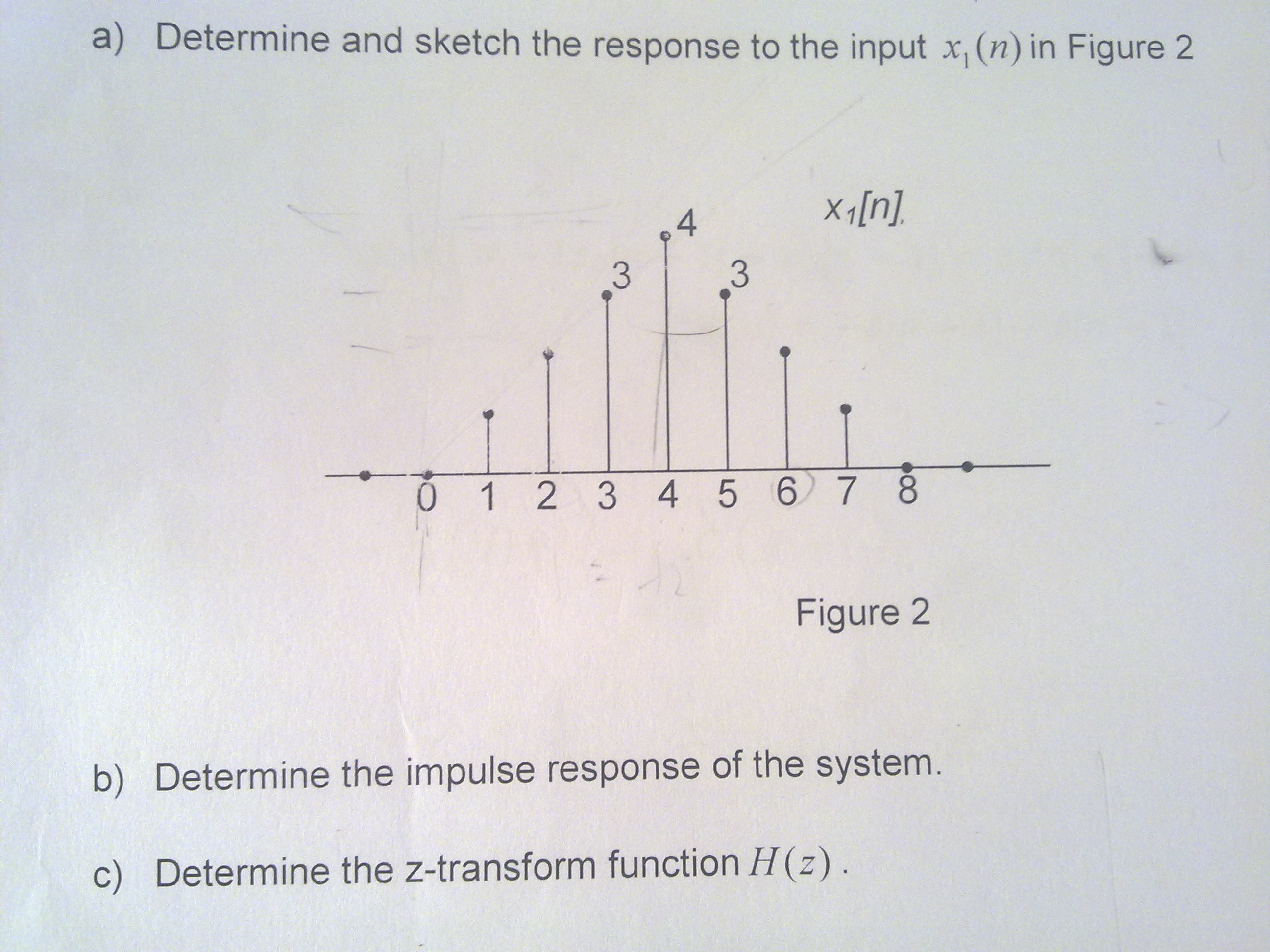

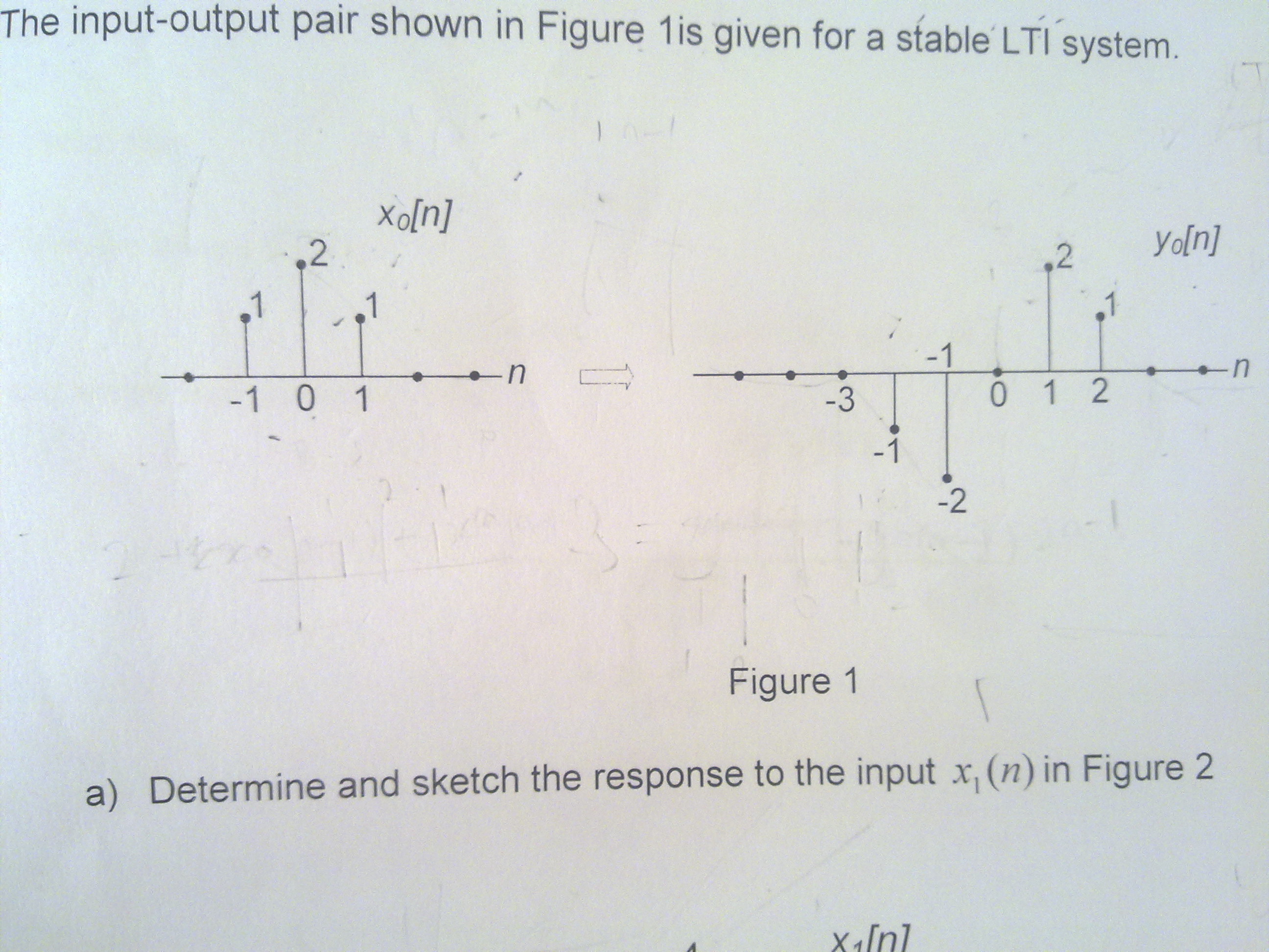

another question it seem simple but don't understand... lolz

Hi again,
Ok i guess i'll start then...
The original question set is shown in the single diagram below.
Since we know that y[k] equals x[k] convolved with h[k]:
y[k]=x[k]*h[k]
(in the above * stands for "convolved with", not "multiply")
one way to solve this would be to try to find an h[k] that satisfies this relationship.
To do this, we could look at each part of the convolution sum and try to figure out how to generate the y[k].
I guess we can do more if he comes back.
