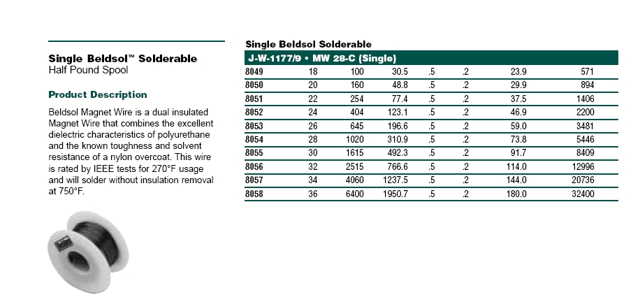

I already said it: You can solder it without striping it first, yet the insulation is very tough, abrasion resistant, and good to 270degF. You can cross two wires without the risk of a short. I have a 1/2lb spool of the Belden 8054, and have made dozens of hand-wired breadboards with it.
The wire-wrap wire I have used has a thermoplastic insulation that is easily damaged, and a crossover can extrude the insulation to cause a short if either wire is heated within a half inch of the crossover.

The insulation is very tough, and is not damaged with just a touch of the soldering iron like that mickey-mouse thermoplastic tie-wrap wire...
Use the Tefzel coated wire wrap wire.
