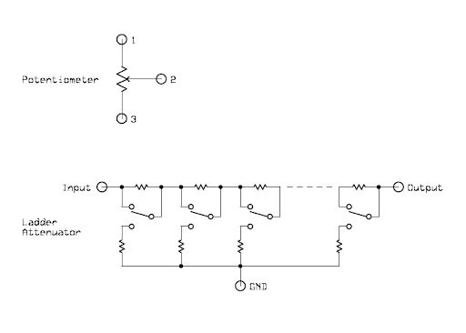

Won't 6 relays give you 64 levels with a binary resistor array?
Yes, if he can live with a linear progression. But I don't think that a logarithmic progression (which is what's usually used for audio) could be made to work with a binary array.
But I'm open to the possibility.
a logarithmic scale that uses the binary system doesn't work?
I don't think so. But then again, I've never tried to make one, so I'm not going to say it can't be done.
Do you have a binary stepped circuit with a logarithmic behavior?

the operating principle is the one in the annex.
the switch contacts shown are those of the relays. the two resistances connected to each contact are calculated to obtain an attenuation in db.
when the outputs of the 2 binary counters are all at zero the switch contacts are all closed and all the resistors are bypassed. on the contrary when the outputs are all high, all the switch contacts are open and all the resistors are used.
