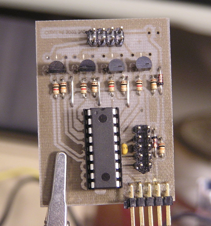

Assembled board
Attached is a pic of the finished board. The switch connector was to close to the processor socket but using a right angle header was a good work around. The problem is fixed foil_1C2.pdf.
This board is setup to bulbs. It can also be assembled for use with LEDs.

Mike,
I should have made the board larger. I will spread things out a bit to make it easier to build. In the past I have given people grief for making things to small:eek:

This is what my prototype looks like. The board I made uses 2n7000 and 100k pull down resistors which are a little high - they take a while to discharge the pin capacitance. I can post the circuit and board if anyone needs a more spread out version.
Next step is to find a nice piece of wood and get working with the router to fit it inside.
