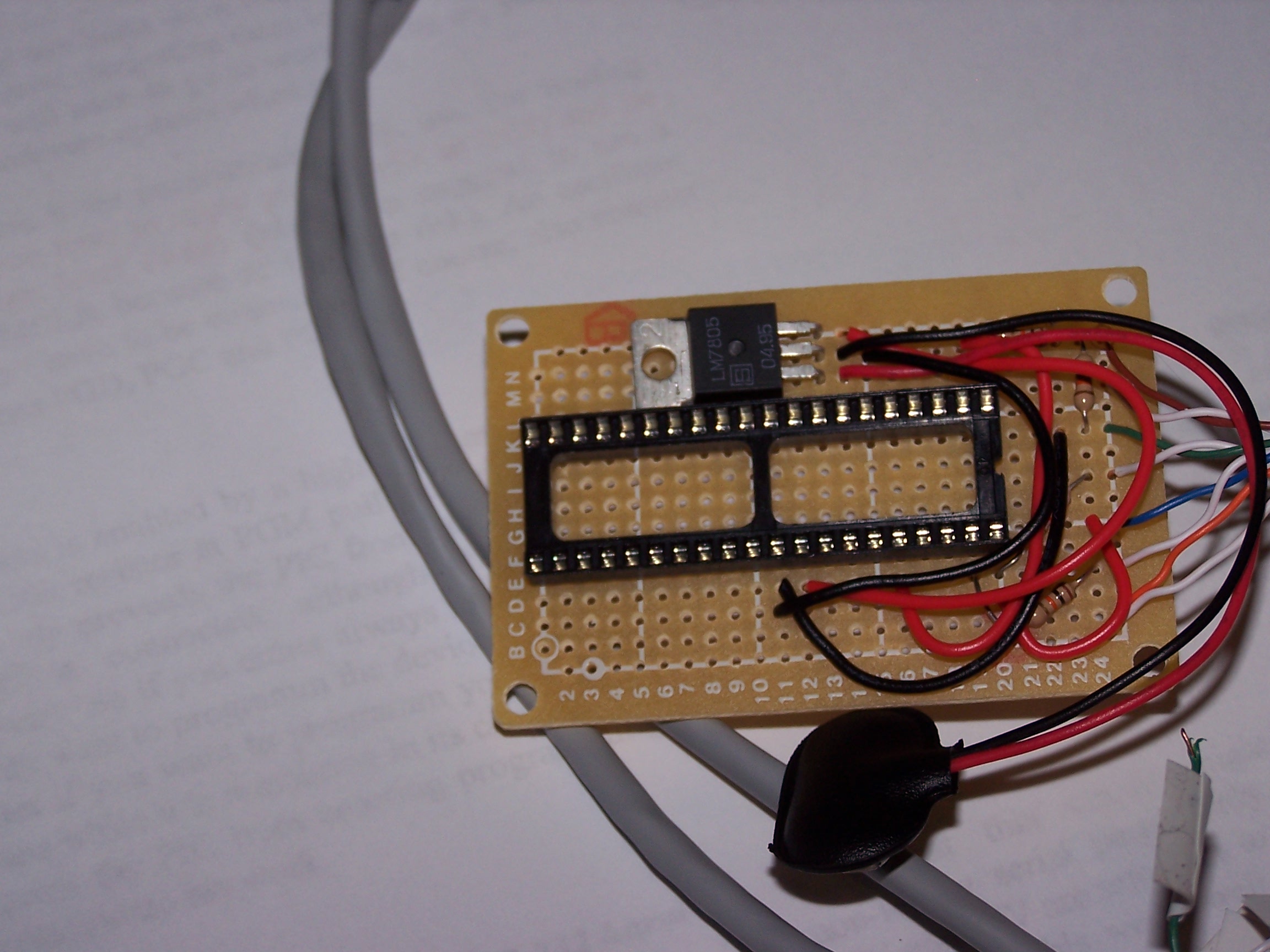

1356: LVP with 40pin socket, 5v regulator, 9v battery clip, and Cat5e wire for the 9pin socket. Went with the picture and my general Idea. HOPEFULLY it works.

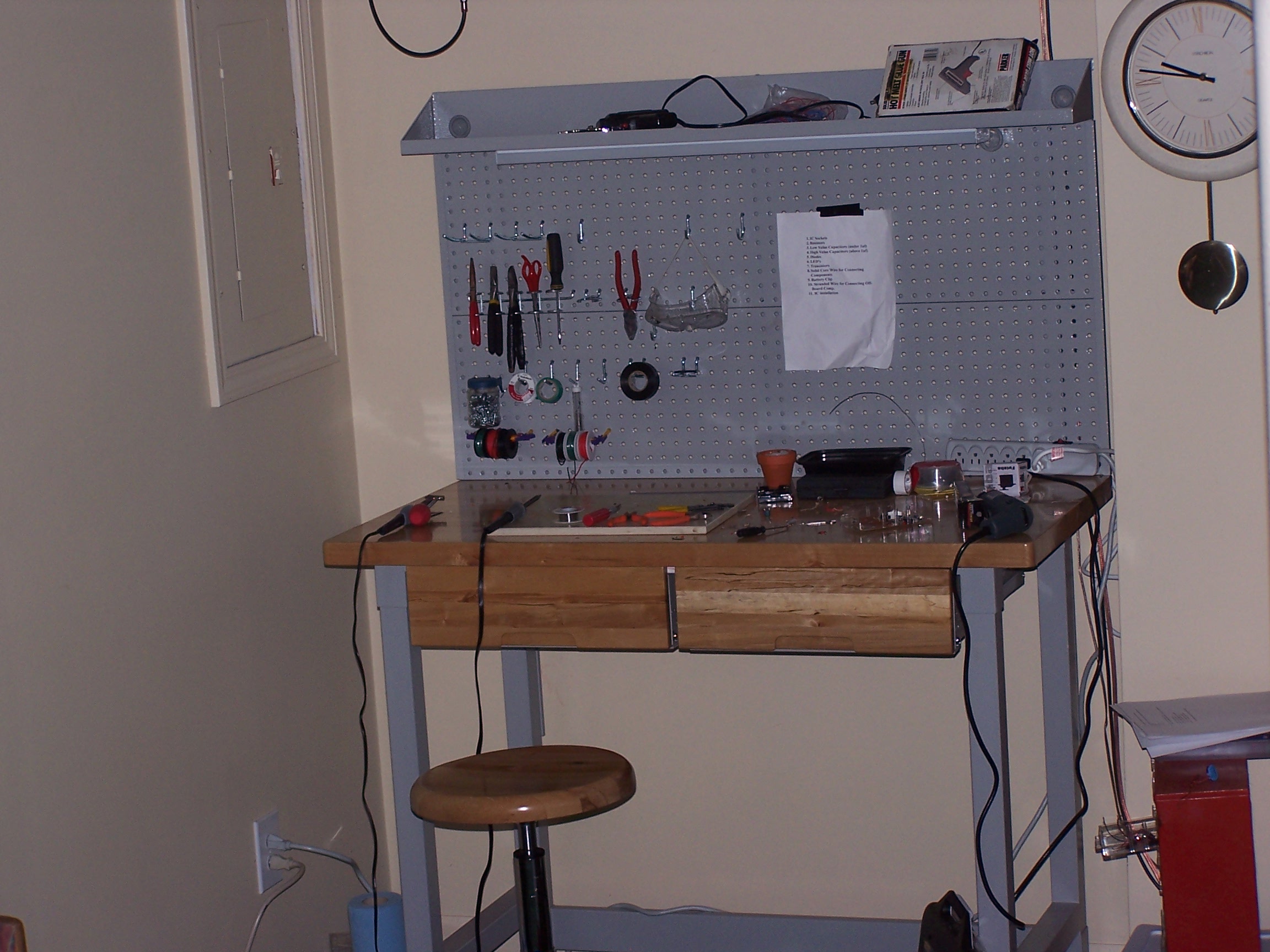

1355: My new workdesk/work area. Works awesome, nice big workdesk, got it june 20th, and already has burn marks, solder embedded in it, and huge gouges, from dropping stuff on it (razors, knifes, cutters, etc).

You need to put your 16F877A into a solderless breadboard and wire it up as shown in Bill very good . You can also do a point to point board or buy some veroboard.
The processor you connect to is called the target.
You could just find the hex file for a blink program or assemble/create one using MPLAB.
All the examples I have seen on the web are setup to work with high voltage programmers and have the LVP fuse off. That is what you do not want.
The code in the poster is meant to work with the inchworm which is a high voltage programer. It sets the config/fuses to 3F7D. This is intended for the Inchworm, the value will set the LVP fuse off (no LVP) and you will be stuck with a PIC you can not program with LVP. You have to figure out what the correct config value will be. See PIC16F877A.... OR you can possibly tell ICPROG to ignore the config value (fuse settings) and set them there. I do not use ICPROG so I can not tell you how. Maybe someone can clear this up.
Use MPLAB to build the Hello World program on the poster.
Select File>Export. This will open a box where you have the option to save the file with or without the config/fuses. Either way be sure the fuses you end up with are correct.
Then start ICPROG and flash the chip with the HEX file created above.
Remove the target from the LVPC and it should run.
