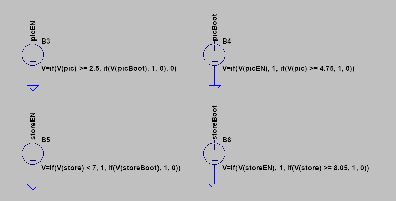

As much as I love this software I equally hate it.
Working with FETs and voltages I find myself more and more using GPIO's to make decisions, which requires emulating the hysteresis logic they'd contain otherwise LTspice goes into loops. Unless I'm missing a trick I end up doing multiple B source's which reference one another. The approach works but after a while the multiple IF's become a pain (I sometimes have 4!).
Surely there's a better way?!?
Q) Is it possible to set params dynamically?
Q) Is it possible to condense these IF's using standard operators: && ||
Does it have emulations of single schmitt triggers such as 74HC14, CD40106 etc?

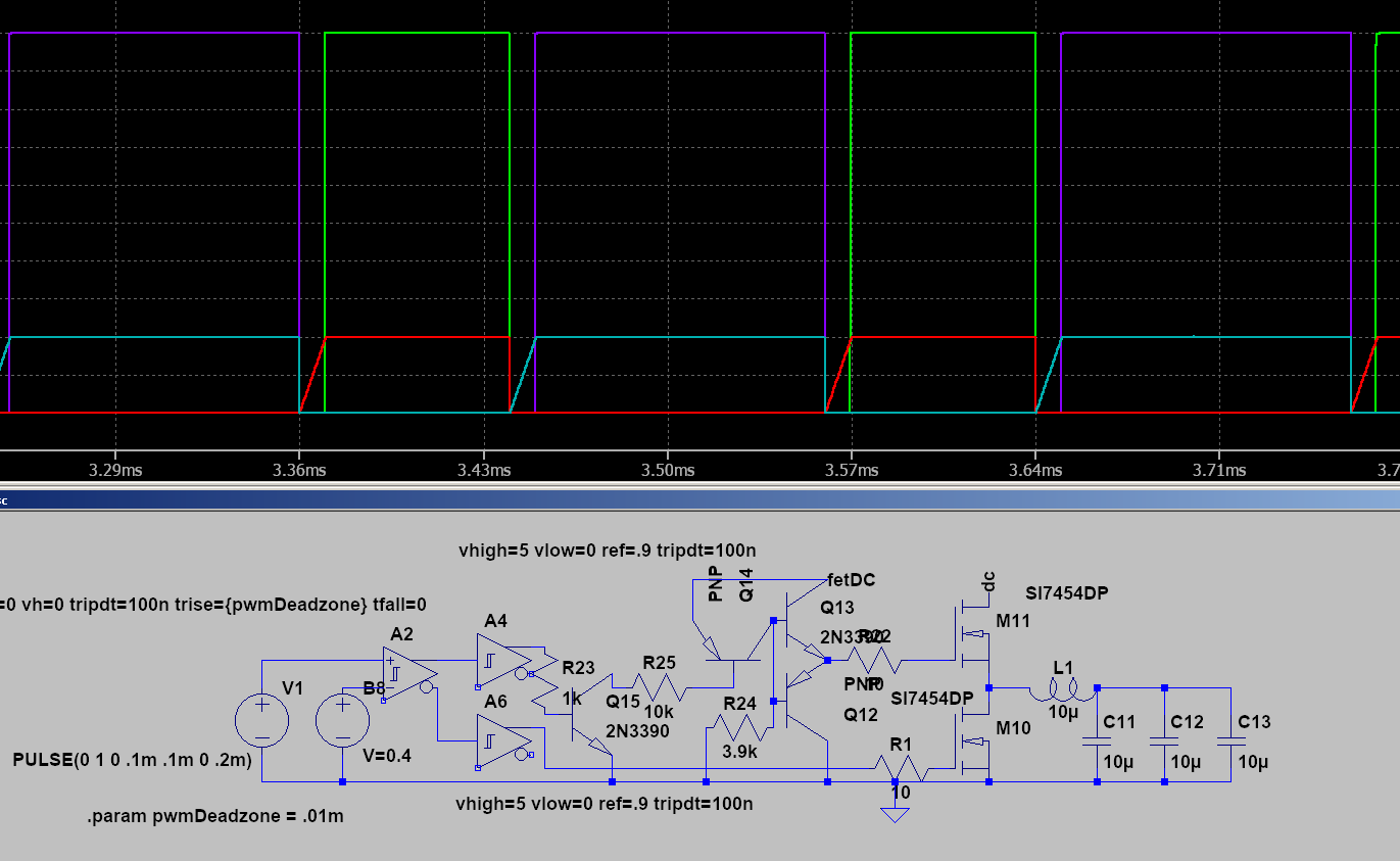

Now, how to get the schmitt inverse pin to include a deadzone?
The A devices don’t support that functionality. You’ll have to use a combination of A devices.
Maybe use a clock source with a leading and trailing edge detectors. The pulse width of the clock source could then set the “dead” time.

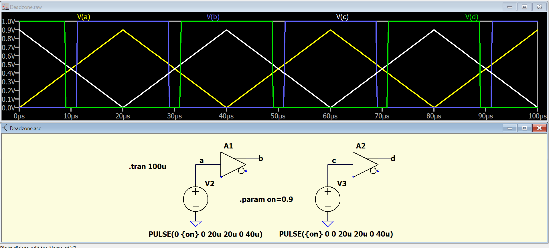

Here's one way :
Param 'on' sets the dead zone between b and d.

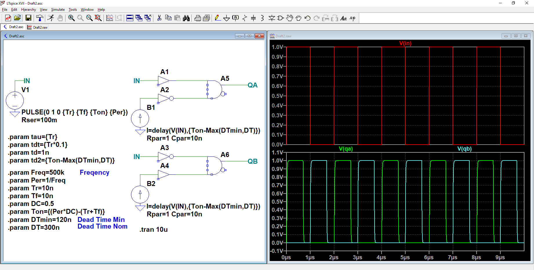

Here's another way.
param DT sets Dead Time
param DTmin sets minimum Dead Time
param Freq sets operating frequency
