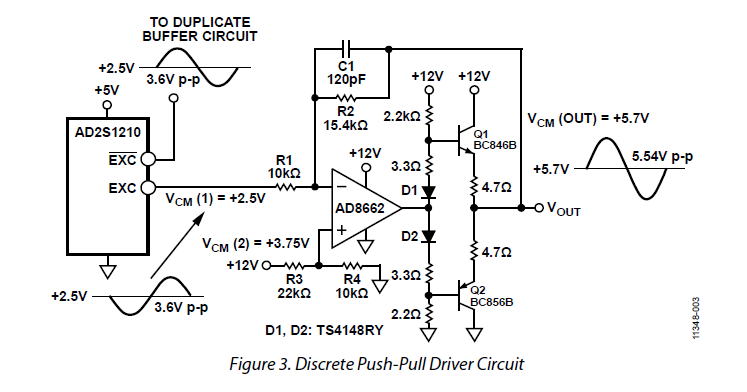

Hi.
I am currently simulating an AD2S1210 output current amplifier from Analog Devices. Circuit diagram published by Analog Devices. But I could not run the simulation. Can you help me?

I do not have a answer. My computer did not like the transistors models. "could not find" I changed to different parts. Still not happy. I removed the transistors and diodes etc. and just have the op-amps. (close the feed back loop) Now it works.
Now I see R6 and R16. Look at them close!

Hi thanks.
Can you share .ASC file of project ?
You LTspice circuit shows a floating voltage source, which the AD2S1210 does not provide.
You need two grounded voltage sources, with their relative phase being 180°.
