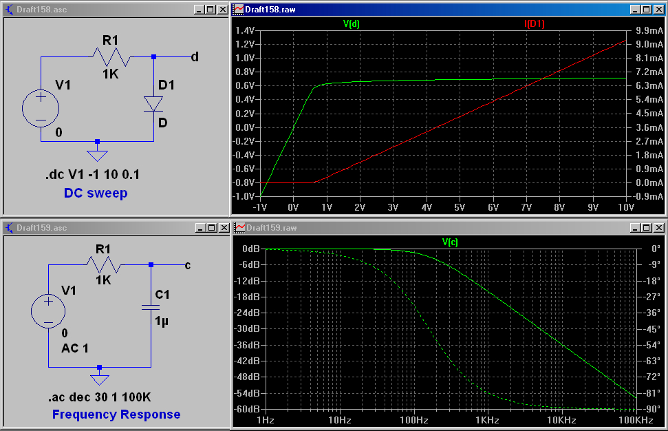

If you mean the output versus input transfer function, the AC function can be generated using "AC analysis" and the DC function can be generated using "DC Transfer" in the "Spice Analysis" Simulation Command window.

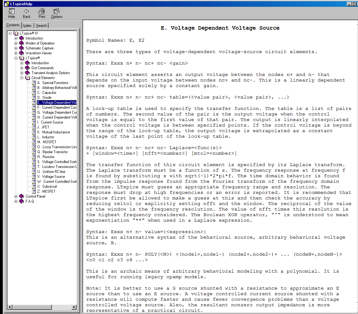

Some simulation programs can find the poles and zeros of a circuit but I don't think LTspice can.
Read this from the LTSpice Help file:
So you can produce a transfer function from a known set of poles and zeros, but possibly not do the inverse directly?
Would it be possible to use trial-and-error to either:
a) match the transfer function (TF) of your circuit under test with a TF generated in the above manner with known poles and zeros, or
b) null the TF of your circuit under test with a TF generated in the above manner by connecting the two in series (or mixing thier outputs)
Alternatively, maybe you could export your TF from an .AC analysis (File->Export with a plot selected) and do some curve fitting or analysis in a spreadsheet or scripting program (MatLab/Octave, etc).
