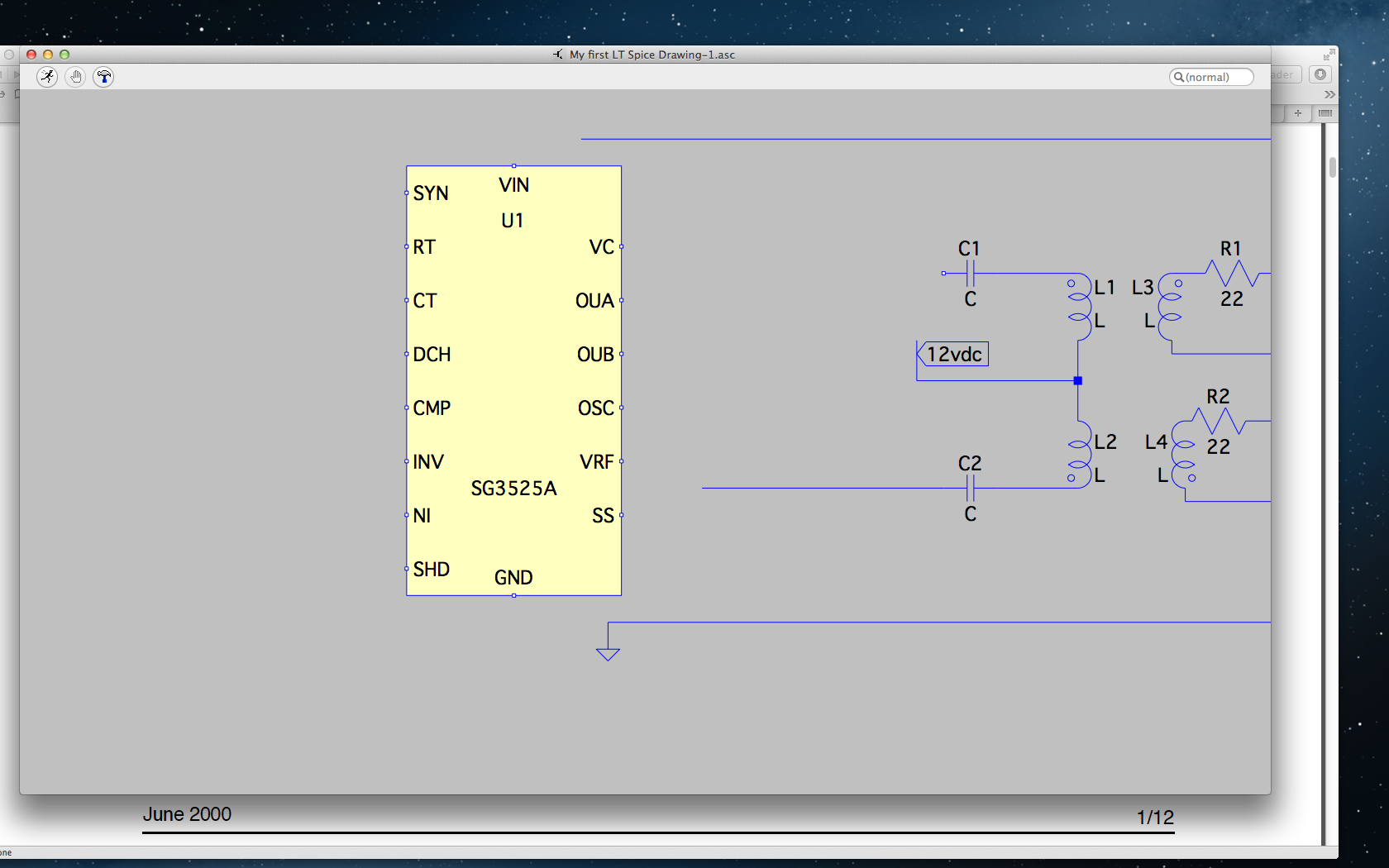

I was able to get it with your files the .asc it wasn't working until I pasted the .asc into .sym I thought the .asy was all I needed, and is the reason I couldn't get it to show up.
If you can attach the two files for the SG3525 I will try to install it and give some screen shots.
I got a chance to come home for lunch, took a little bit, but eventually it work.

I got the Zener in but, I can't read the values,,,,, for the MKP Cap on the Datasheet.
All I can understand is "V" rating and "uf" the rest is a garbled mess to me.
Should I just leave the rest Blank?
See if I missed something.....DataSheet> https://www.vishay.com/docs/28128/mkp416to420.pdf
Just the capacitance value is fine. Don't even need the voltage. Spice will let you smoke it. :woot:

Pin location does not matter in spice. Only the pin name/function.
Even for schematic drawings, pins are usually placed by functional groupings that are often different than the location on the chip.
I have been working on the pin name and function, I hope I can jump my wires to get to the respective pins, that's if they will line up with the other schematic.

Chris, I realized if I just run over the wire it won't attach to another one.
Here is what I have so far....
  • My first LT Spice Drawing-Electrotech.asc
Ok, it's time for the dreaded core of the Transformer, I have 22g wire and 14 turns of 4 wires with this core.

To start with just fill in the 'uF' part. If you want to get more accurate then work in the L and R part of the cap. Because this is not a low current timing cap don't worry about parallel resistance.
Look at the end of the data sheet at a graph called IMPEDANCE.
Look at a 1uF cap. There is a line starting high on the left and sloping down. This is what a 1uf cap should do. When the curve slopes up to the right this is what a inductor will do. Above 600khz the cap looks inductive. At 2mhz it is about 0.3 ohms. This gives us the inductance of the leads and connections inside the cap. (ESL) The resistance of the cap is 0.008ohms. (ESR) A perfect 1uF cap should have 0.01 ohms impedance at 2mhz but this cap will have 0.3 ohms. The real cap will have high frequency ripple, above 1mhz and a slight tendency to ring at 600khz.
When working with high current caps in power supplies the ESR and ESL makes the simulation more like the real world.
Thanks, Ron good explanation, I have to go to work now, it will take some time for me to consume what you said, but I got the last part of it. I'll try to apply it and get back to you.
As for my Core and windings of the GDT, I'm stuck again. I don't know how or what to do to make it work in the schematic.
