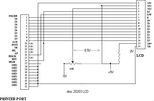

Can you post the circuit showing how the LCD is connected to the paraport.?
How long is the para cable.?
Do you have a LCD datasheet you could also post.?
sorry for long time to respond, i have been bussy, i am a student you know.
e schematic yes here it is
you can find datasheet overhere.
DMC20203 (Optrex) - Lcd Module Specification
i have modified a schematic for power source, i do not use backlight, that is the only modification.
This is my first LCD project, i am working with computers usualy but i want to enter this kind of electronics, so be free to tell any mistake i made, even it is very funny.

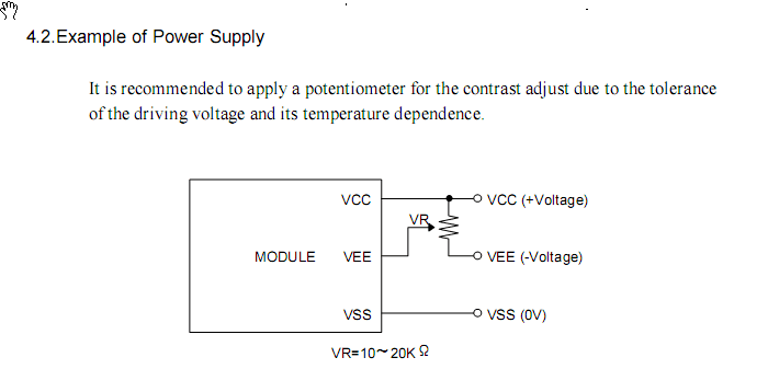

Looked thru the data.
It appears your LCD requires a -V for the Vee.
The Controller is a standard HD44780 but the drivers and the biassing show that a -Vee is required in order to make the pixels visible.

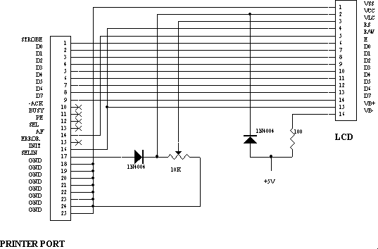

Look at the attached dwgs.
The LED backlight requires a fairly high current, DONT try to switch the LED cathode with the parallel port. I have removed that link from your sketch
When you have wired the LCD 10K contrast pot as per the datasheet, try adjusting the pot until you can see the black pixel blocks.
Let me know how it goes.:)
EDIT: Have you downloaded port95nt.exe from that Smartie site.?
well i made connections as you specified. and i see the black boxes, but the text is not going. i aplied 5 and -5 volts, from external power supplays, current is about 100 mA. i have backligh but i do not have text.
