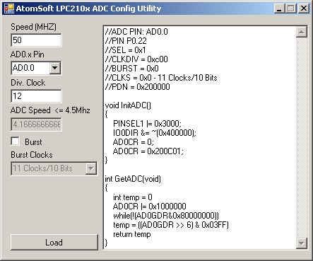

LPC210x ADC Config Utility
AtomSoft
lpcadc-jpg.47845
This is REV 1. Should have mostly everything for BASIC ADC usage and stuff. No interrupts yet. Sorry. But works!
I already merged the code from UART and ADC and can read a POT on RealTerm at 115kbps. Awesome!
