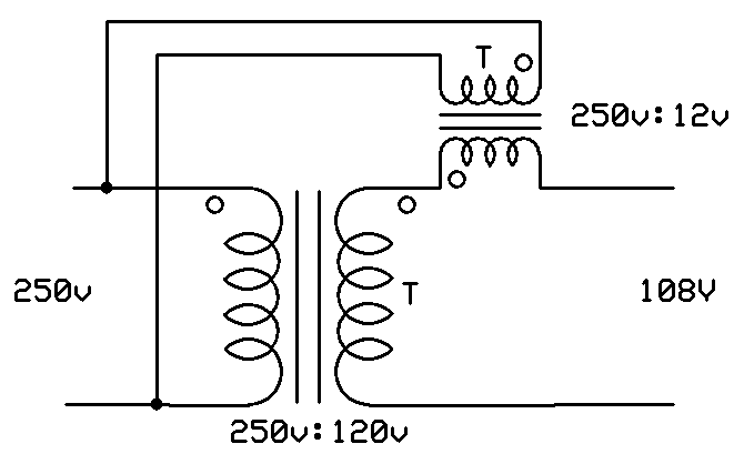

Another trick is to add a low voltage control ("filament") transformer to the secondary of your mains step-down transformer. The control transformer's secondary current rating must be the same (or greater than) as the main's secondary. The primaries are connected in parallel and the secondaries are connected in series. If the phasing of the secondaries are the same, the output voltages add. If the phasing of the secondaries opposite, the output voltages subtract. The latter is what you want.

This is a very interesting trick - the only problem is that most standard 240v:12v transformers are designed for low current (probably up to 1A) - but if I find a suitable one I'd definitely try this! I would think that if I wanted say, 2A - I would have to find a 240v:12v with secondary's rating of more than 2A.

No, if you need 2A, you can pick a transformer with secondary rating of 2A. More doesn't hurt, but is not necessary. With center-tapped transformers and/or multiple transformers with different output voltages, you can get lots of different output voltages. There are a lot of higher current control transformers in the surplus market, and on eBay.
