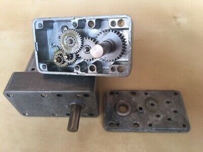

This is the closest setup I can come up with at a reasonable cost, without going to such as electric wheelchair motors..
A decent geared motor:

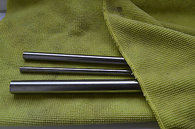

You would have to add some kind of winding drum and a timing belt reduction from the motor to the winding drum.
eg. Using 8mm bore 12 tooth and 60 tooth pulleys plus a suitable belt would give a further 5:1 reduction
The output shaft would be some 8mm ground rod
Running on 8mm pillow blocks:
That give a maximum speed of ~30 rpm on the output shaft, which can be lowered using a 12V speed controller or lower voltage power source.
The geared motor is rated at 20Kg-cm and with the 5:1 belt reduction the final torque would be 100Kg-cm absolute maximum, so well above the minimum needed.
As long as you use a reasonably small diameter winding drum on the output shaft, it should lift 5Kg easily and have a decent operating life. Choose the drum diameter and motor voltage to get an appropriate winding speed.
