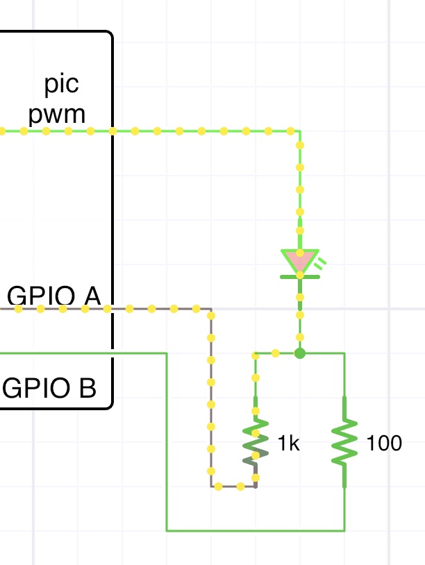

Your LED is low enough current to allow sourcing and sinking from pins on the PIC. So you can simply apply power from your PWM pin and select a ground pin connected to a different current-limiting resistor that suits your needs.

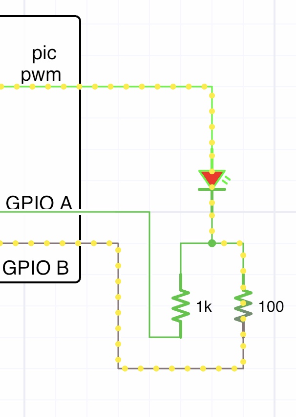

This way you get 1-255 duty cycle on a 100 ohm resistor (30 mA), then switch the ground pin to an input, then switch another pin from input to and output low, that is connected to a 1000 ohm (or 22k ohm) resistor (3mA) for 1-255 duty cycle.
In pictures,
Or
